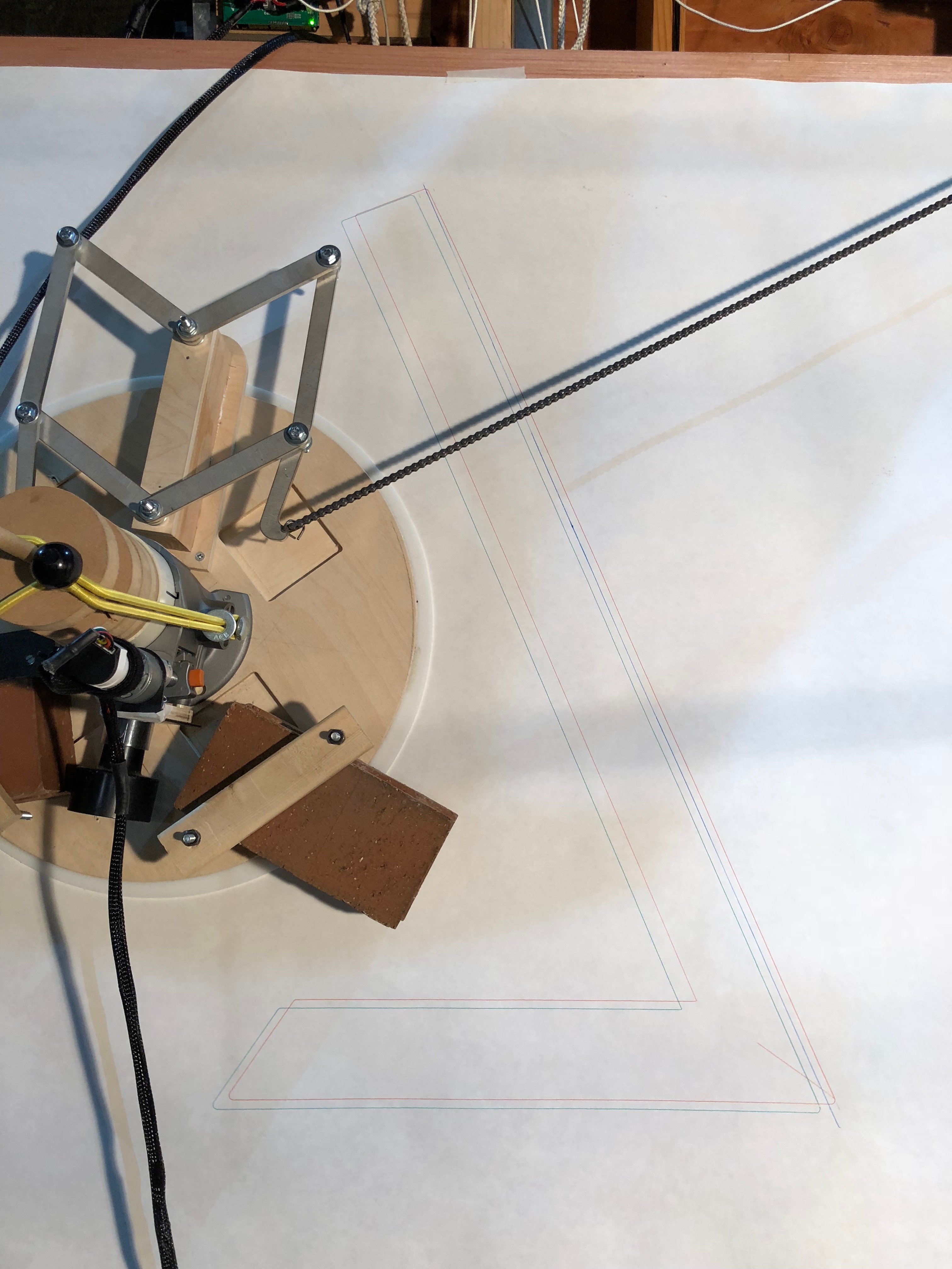

Here’s what I see so far when I look at this issue:
  • My machine is set up as a bottom-feeder, so I chose to try the v1.03 motor.cpp in the v1.06 firmware framework. I made sure the PWM was set to the default 490Hz
  • I’ve simplified the trapp2.nc file by commenting out everything but the outline.

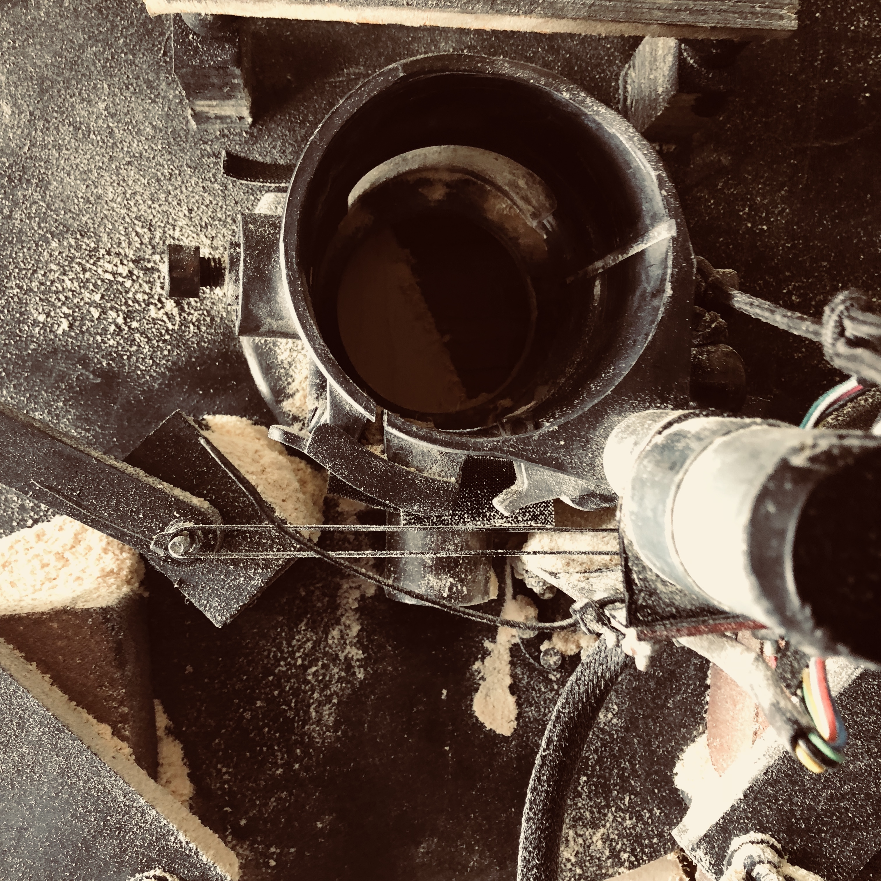

  • I’m plotting with 0.8mm pens instead of a spinning router bit. The green pen was plotting the v1.06 version of motor.cpp, the red pen with v1.03.
  • I’ve drawn a ruler-straight blue line between the two outside diagonals, anchored halfway between the two at the bottom end and at Y=0".
  • Both green and red lines are straight and parallel to the blue line below that midpoint. In fact, they are still parallel to the blue line until about y=4". The arc seems to start above that.
  • the red and green line are parallel along their length to less than 0.5mm, both arc equally. At the top end I measure both to be 5mm from their correct position.
Have to wait and see what others find, but provisionally the cause of the arcing doesn’t seem to be the changes to the motor controls.

P.S. Cool pen holder! I’m not sure I’ve really seen a picture of it in the wild before :grin:

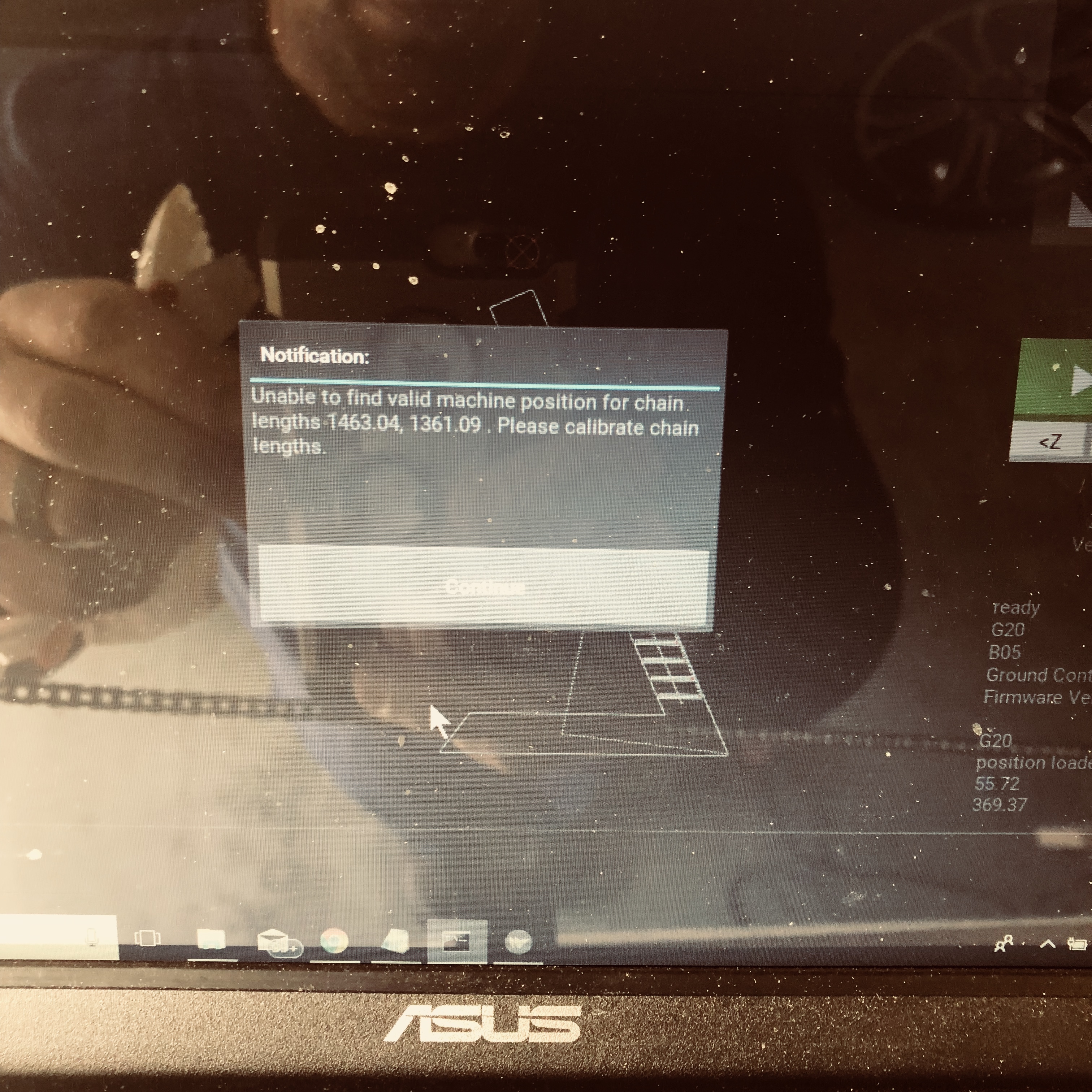

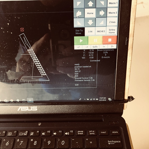

As a long shot I reloaded 1.06 firm and gc and this is what I got. I dont recall seeing the warnings before when I loaded but wasnt looking when I first installed
I think that ‘unable to find machine position’ is significant. that means that the forward kinematics calculation isn’t working

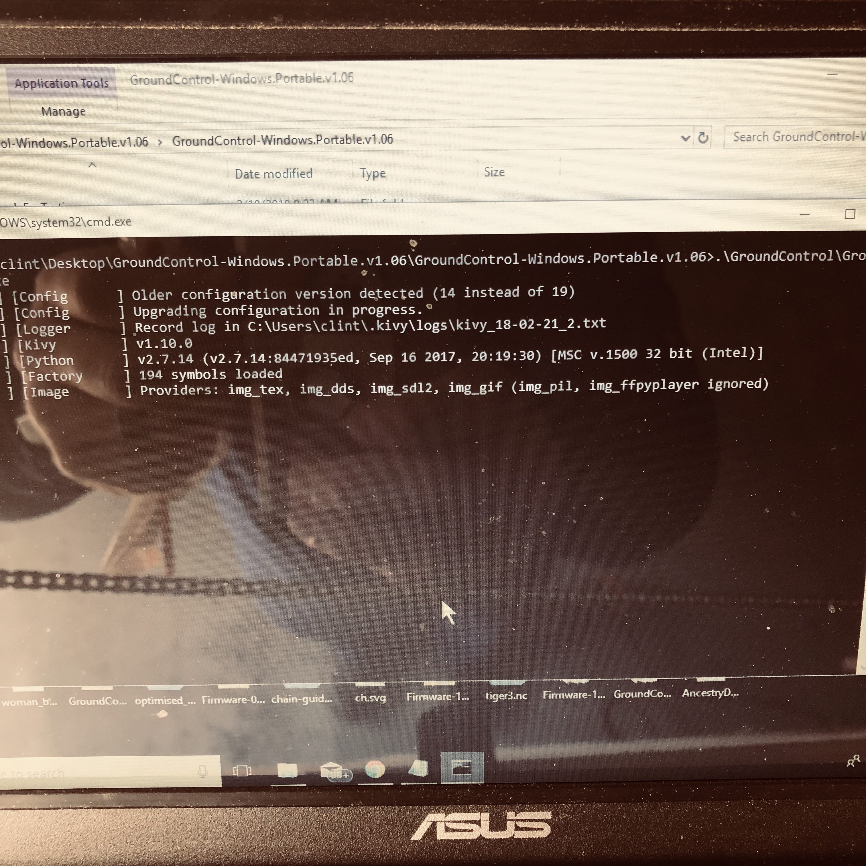

The last image I posted above shows- warning older configuration version detected (14 instead of 19). Where is gc reading that info from (log)?
There is a version in the ini file
GC keeps it’s version number in a file data.py, the firmware in Maslow.c. GC requests the firmware version number with a ‘B05 \r\n’ command, and GC adds its version number to the resulting printout as well.

Today I removed 6 pounds from my sled (became 18.5 pounds after removing) to see whether weight made a difference from yesterday’s curved cuts. It did not, the line perfectly matched the curved cuts from yesterday.
Then I re-rigged to the top-feeder setup and ran the trapp2 outline using firmware with both the v1.03 motor.cpp and the v1.06 motor.cpp. Both produce a perfectly accurate pattern. Ruler straight along the whole angled length. The difference from yesterday’s curved cuts was the change from bottom-feed to top-feed.
