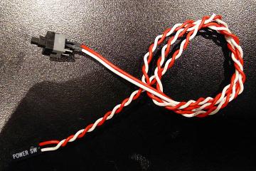

Simplest hardware solution is a push button between GPIO3 (pin5) and GND (pin 6)
RaspberryPi Power Button
All that is required is to add a line to /boot/config.txt :
dtoverlay=gpio-shutdown,gpio_pin=3

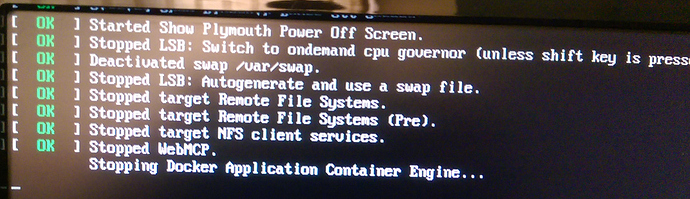

All file system tasks and write operations shut down right away. I assume it’s safe to power off directly.
It takes 2min and 22sec for WebMCP and Docker to stop.
A few seconds later the screen turns off.
Only at this point, the button works also to wake up the Pi again.
My guess is that you can turn of the power directly after pressing the button and don’t have to wait the 2 minutes. From the file system messages, neither WebMCP nor the Docker should be writing at this point. Correct me if i’m wrong, please.
This shuts down in the same way as shutdown -h now or halt does. It does not completely cut the power (like some hardware add-ons do).
