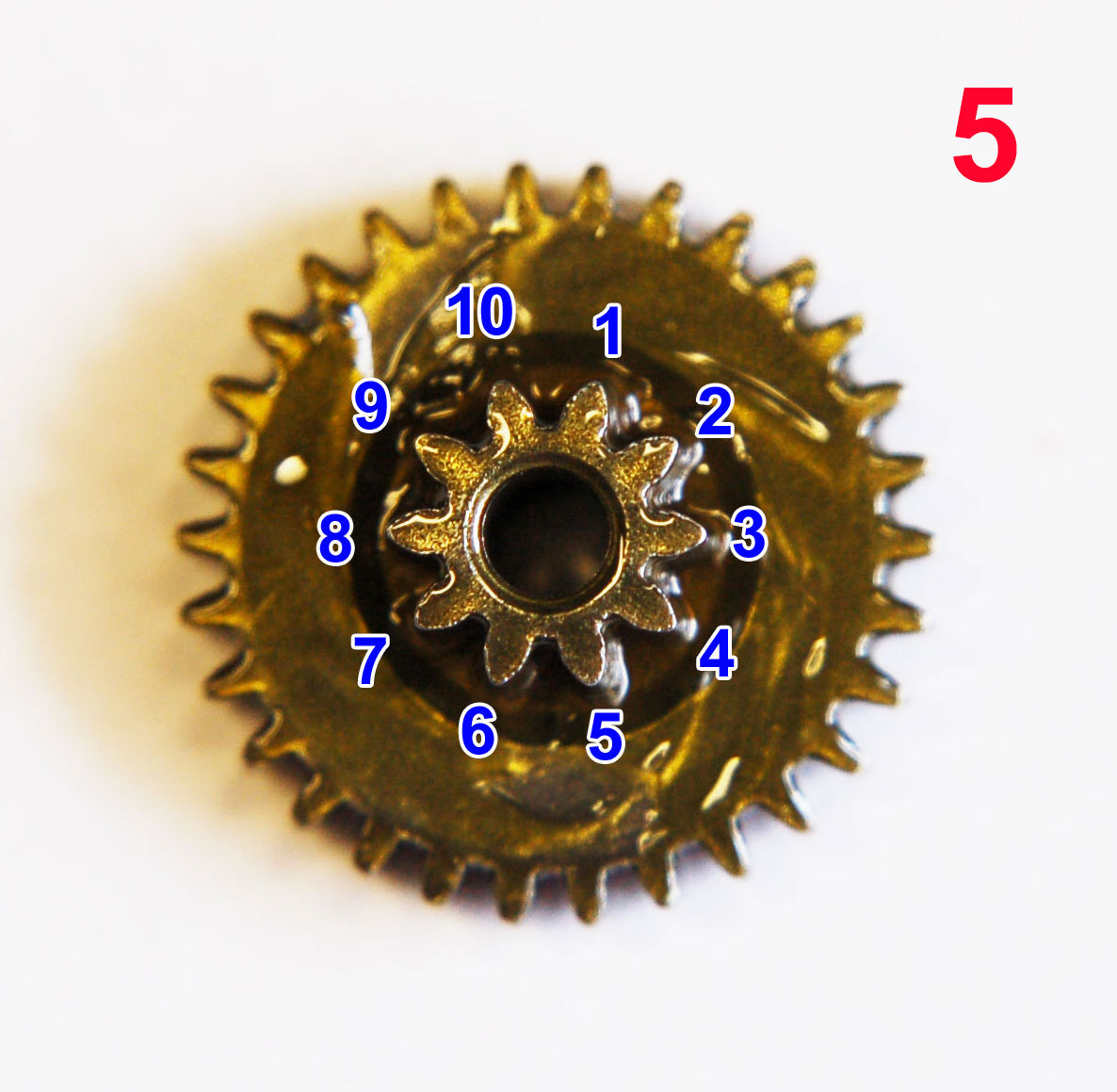

Whats inside the gearbox/motor?
you need to count the number of teeth on both the large and the small parts of
the gear, you then multiply all the ratios together
so the final output is 40:1
the next four gears I count 30:10
and on the motor I count 1:12
so 40:1 * 30:10 * 30:10 * 30:10 * 30:10 * 1:12 = 270:1
@dlang Thanks.
@2cents - there you go. 270 is right.
Woodcutter4, I just now saw this today. Being a newbie to these forums, I’m still trying to figure it all out. I did actually read this one where the motor has been taken apart and have taken mine apart even before reading it. I plan to take it apart again and like you said, do the math. I have the two main motors and the Z motor is on order. I’ll have to see what I get.
Here you have the pics
Just to confirm
30:12 * 30:10 * 30:10 * 30:10 * 40:10 = 270:1
