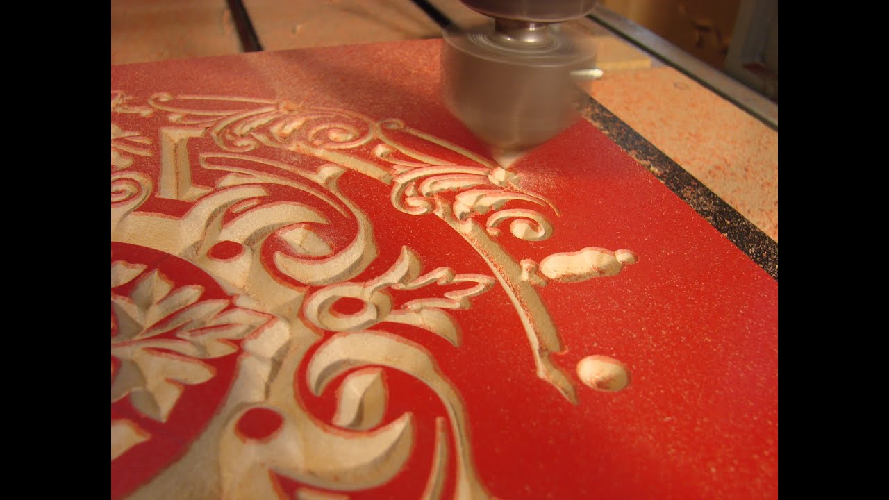

Take a look at the movement that’s needed for this sort of thing:
that requires that the Z axis be fully coordinated with the other two axis.
The Maslow would be a fantastic machine for creating big signs, but to do that,
it really needs to be able to do this sort of movement.

We should not put another band-aid on this problem, but instead make the
coordianted move handle all three axis and fix it for good.
Oh we already have the code. I wrote it a long time ago. Coordinated movements for lines is done, it just needs to be updated and can be merged in. The arcs in 3D planes has some issues (turning in the wrong direction) that I stopped working on a while ago. I can split it up so that we are not waiting an eternity for me to fix things.
