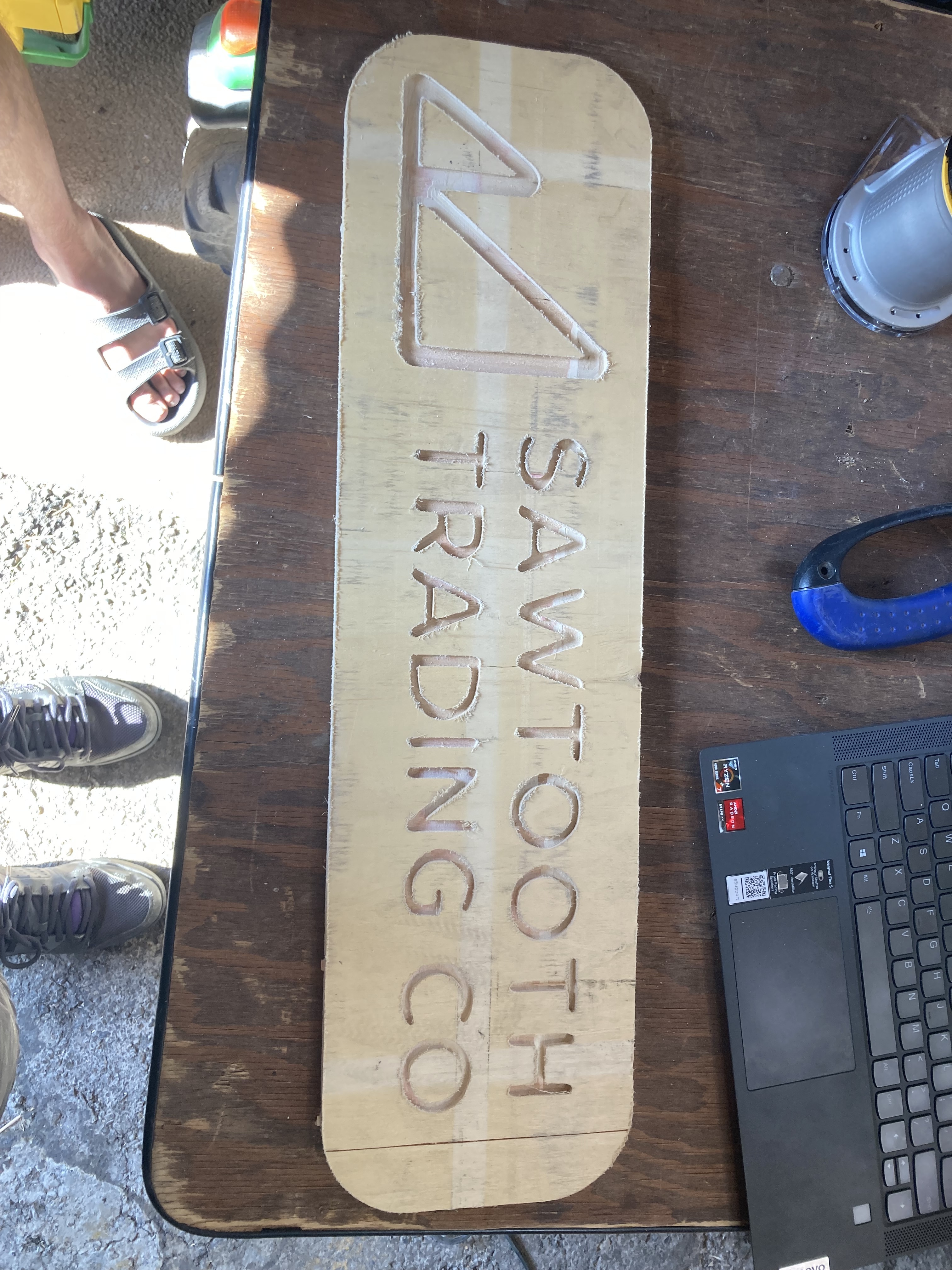

What are you making? Share pictures!

Great success! Feels so good finally up and running. Thanks everyone for the assistance!
The change to the fusion output settings did the job.
Beautiful! Glad to hear that worked and we found a solution! Thanks to everyone for the help too!
Those are fantastic! Great work!!
