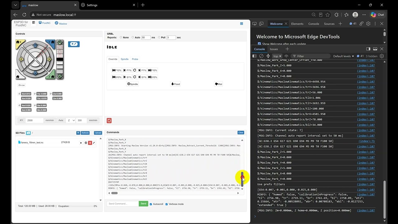

Z-Probe works but gets ERROR:2 with ZNaN on retract (Web UI v1.24.0 / FW v1.24.0)
Hi everyone,
I’ve set up a Z-probe on my M4 following the instructions from this thread. The probe triggers correctly and stops at the plate, but I’m getting an error during the retract phase.
My Setup:
text
probe:
pin: gpio.48:high:pd
toolsetter_pin: NO_PIN
check_mode_start: true
hard_stop: false
Probe panel settings (Preferences → Show probe panel):
  • Max travel: 50 mm
  • Feed rate: 100 mm/min
  • Touch plate thickness: 1 mm
  • Retract distance: 1 mm
What happens:
  1. I press the Probe button in Web UI
  2. The router descends and touches the probe plate correctly
  3. The probe triggers and stops (I can see [PRB:...,1.616,0.000:1] in the console)
  4. Immediately after, the system tries to execute: $J=G90 G21 F1000 ZNaN
  5. This results in: ERROR:2 Missing the expected G-code word value or numeric value format is not valid
Full console output:
text
[PRB:0.183,5.045,-9.820,1.616,0.000:1]
[MSG:INFO: Probe offset applied:]
ok
ERROR:2 Missing the expected G-code word value or numeric value format is not valid.
Current workaround:
After the error, I manually:
  1. Go to Setup → Set Z-Stop to set Z=0
  2. Manually jog Z up 5-10 mm
This works, but it’s not ideal for a workflow.
What I’ve tried:
  • Verified preferences.json contains the correct values:
    json
    "probemaxtravel": "50",
    "probefeedrate": "100",
    "probetouchplatethickness": "1",
    "proberetract": "1"
  • Changed Retract distance to different values (5, 10) — still gets ZNaN
  • Rebooted the controller multiple times
Question:
Has anyone else experienced this and found a fix?
Thanks in advance for any suggestions!
Looking at your console log, the probe itself is working. FluidNC returns a valid PRB result. The error happens after that. The Web UI is sending “ZNaN”, which means it calculated an invalid number for the retract move. So the controller is just rejecting that bad command. This looks more like a Web UI retract bug than a probe configuration issue. I’d try opening the browser dev console while probing to see if any JavaScript errors show up and also confirm the WebUI version is compatible with your FluidNC build. The probe hardware seems fine; it’s the generated retract command that’s breaking. It could help if the Web UI validated the computed retract position before sending the $J=G90 command. For example, after a successful PRB, confirm the returned Z is a finite number, and if not, show a clear error instead of sending a malformed G-code. That would make the probing workflow way more robust and prevent this ZNaN type failure.

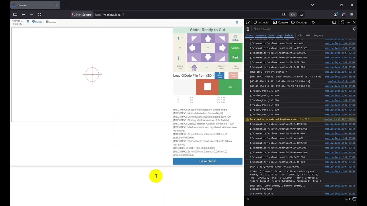

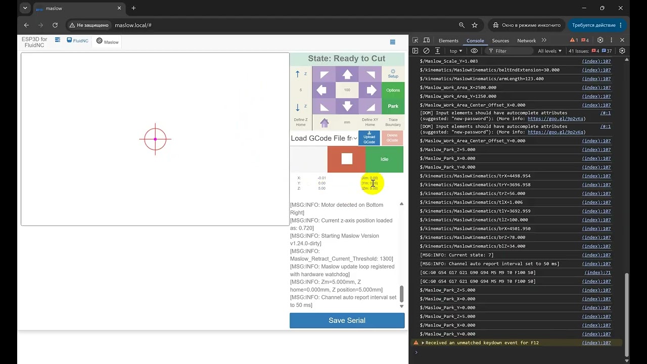

Yes, the sensor is working fine; this is a software-related issue. I tried to reproduce it in different browsers. I’m including links to some YouTube videos. Maybe this will help clarify the issue.
Chrome Error Z-Probe works but gets ERROR:2 with ZNaN on retract (Web UI v1.24.0 / FW v1.24.0)
Edge Error Z-Probe works but gets ERROR:2 with ZNaN on retract (Web UI v1.24.0 / FW v1.24.0)
Firefox Error Z-Probe works but gets ERROR:2 with ZNaN on retract (Web UI v1.24.0 / FW v1.24.0)

I’m not using the probe functionality, so I can’t test it, but I created #1082 which came back with the following which may fix it:
firmware.bin (1.9 MB)
index.html.gz (139.4 KB)
