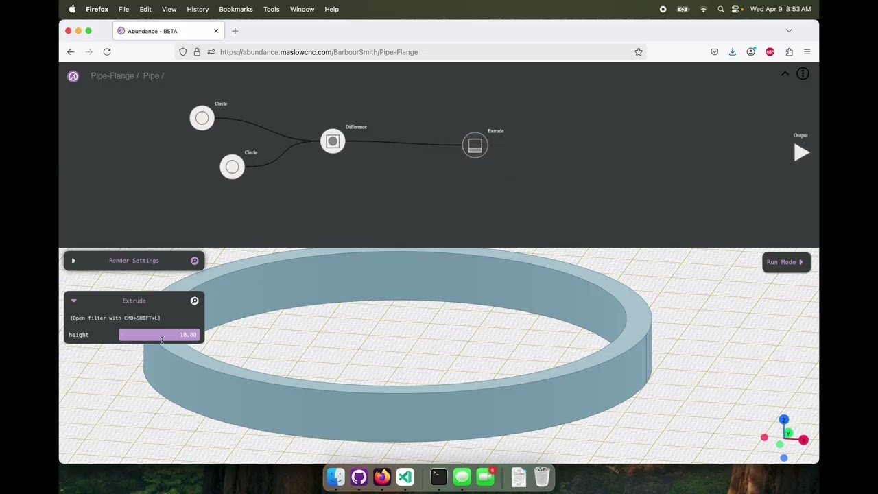

We’ve been working on a free and open CAD/CAM option. It is still VERY much a work in progress, but I would love feedback and info about any bugs that you find if you give it a go!

what CAD system is this interface modeled on?

you need to have some minimal instructions or a link to a video in the software.
I could not figure out how to do anything at all with it until watching the
video.
It’s completely custom, it’s not modeled on anything. The Kernel doing the calculations is OpenCascade (The same one FreeCAD uses)
I’ve seen similar in Grasshopper for Rhino and other applications.
According to my AI overlords it’s called node-based programming or graph-based visual programming. Maybe not exactly what Abundance is up to, but you can see the similarities.
In this style:
• Nodes represent operations, functions, or components.
• Wires (or connections) represent the flow of data between nodes.
• The entire program is structured as a graph, often a directed acyclic graph (DAG).
It’s dataflow-driven, meaning that when a value changes, everything downstream is recomputed automatically—ideal for parametric and procedural modeling.
Used in other CAD and design programs for parametric type flows. Autodesk Revit Dynamo, Siemens NX, Blender, Houdini. There is a node editor for Freecad. It also reminds me of wiring/patch type systems like Max/MSP. PyFlow, etc.

Ha ha, yes - first thing I wanted to draw was a trapezoid… Maybe there is a way to shrink wrap it, but I decided to investigate the code atom instead, which seems to work, as I was able to get a trapezoid shape working, though I’m not finding debugging very sophisticated. if you close the editor, and click on the atom it will show an error, but not much detail about what/where/etc.
I was able to import an SVG and then extrude it. It doesn’t pick up the size from the file, so get the ‘width’ from your drawing program of choice so you can specify that in import setting. Seems like you have to delete the atom to change the file…

I agree, we need a much easier way to read debug messages from the code atom.
I would probably use loft for that, but I think we might want to add a “point” atom which could be used with shrinkwrap.
