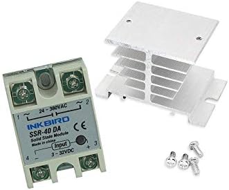

Hope you or someone else could answer a question for me. I want do a relay to turn my router on and off as well, but couldn’t find one of the ones you did. Looking at one of these, as I gather the Router pulls 11 Amps max, but i am never sure how to read the specs.
it says 40 Amps 24 - 380 VAC. Im assuming that 40 Amps is at 24 VAC, so that would be around 10 Amps at 110 VAC? Then it says 3500 Watts, and according to Ohm’s law thats 31 Amps? So more then enough for this application, right?
40A SSR SOLID STATE RELAY for temperature controller
Specifications:
Load Voltage: 24-380VAC = max voltage of motor being switched
Load Current: 40A = max current of motor being switched. only needs to be 20% greater then max amps of motor.
Input Voltage: DC 3-32V = max voltage used to switch the relay
Thanks, the bit i don’t get though, the Voltage is a range, and the amps is a specific number. 40 Amps at 24 volts is ALOT less then 40 Amps at 380 Volts? Or am I misunderstanding the way Amps work? No electrician.
Or does this mean 40 Amps at 24 volts and 40 Amps at 380 Volts or anywhere inbetween???
Excuse the ignorance, but a question un-asked is a question never answered. :slight_smile:
Amps is current and what leads to heat…
If you for example have 120 volts on a cable and run 12 amps through it, it’s essentially the same amount of heat created as running 240 volts at the same 12 amps. (assuming the cable is rated to carry the voltage ranges)
Wattage is Volts x Amps so in the example above, you would be sending twice the wattage at 240 volts vs. 120 volts. Wattage is the real measure of “power” i.e. a 1000 watt heater is warmer than a 500 watt heater.
Wires are typically sized for the amps. So if you think about it, sending 380 volts at 40 amps = 15.2kW if you try to send the same 15.2kW at 24 volts you would need 600+ amps (this would require very thick cable and generate a good amount of heat). Increasing the volts is how they are able to send a large amount of watts over a relatively small cable (low amps).
Hope that helps.
I didnt see a wattage rating in that link. maybe a different product?
To add to what @paulp said, Volts are volume, like turning the water faucet on all the way (380v) or letting it trickle (24v)
Amperage is like the pressure that pushes and/or pulls the volume. too much pressure, stuff breaks.
Yes
