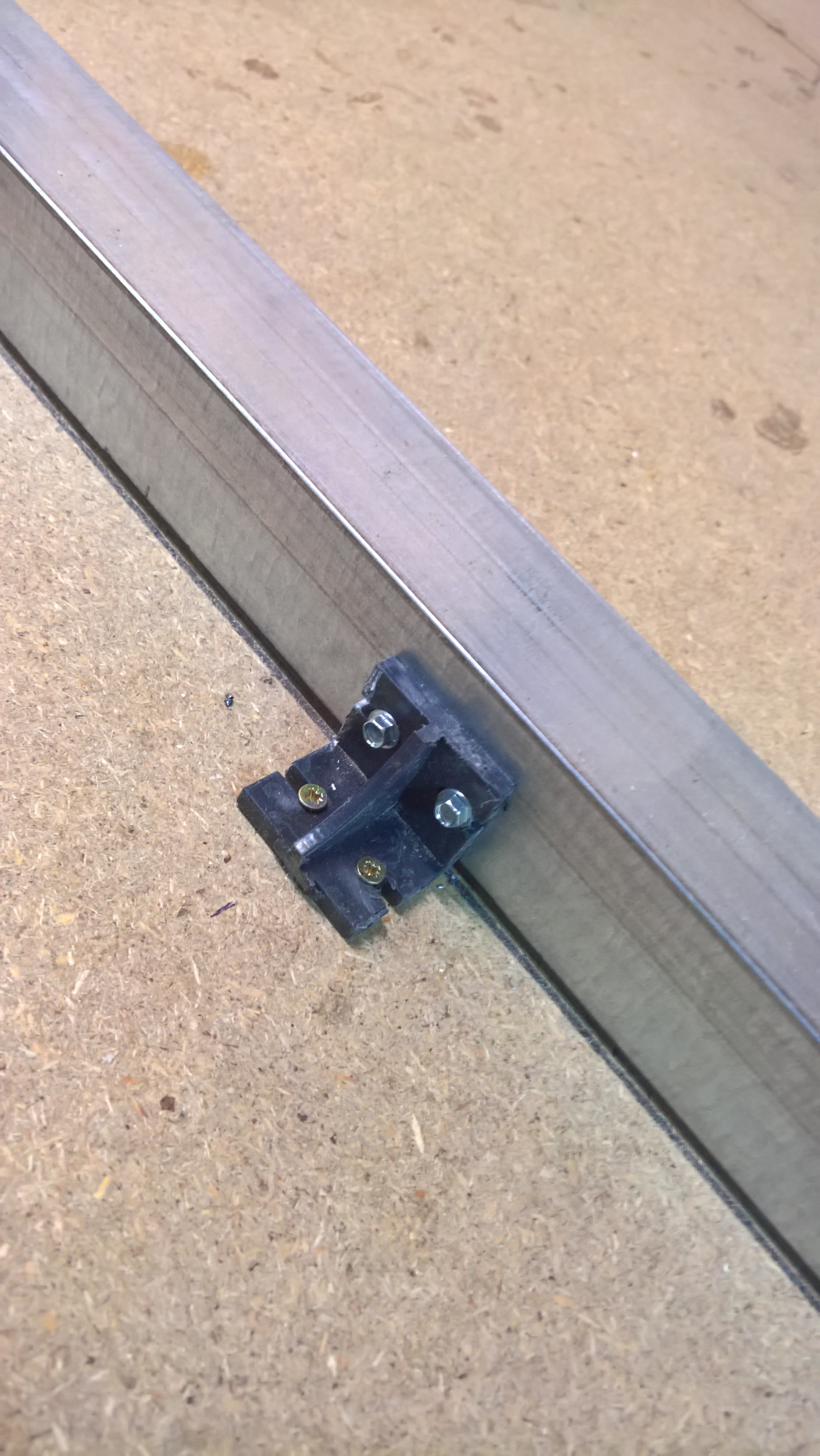

I will stay near a ratio 2x1 / 8x4 /2440x1220 for my new frame. I will try 3100mmx1550mm.
We don’t know exactly how the width and height effect the accuracy. A discussion is here.
Yes, I have lots of trouble with my over 1 year old setup. I have huge humidity and temperature differences and my old frame is useless now. I will build the next out of aluminium. Time is money and I don’t have both at the moment, so I’ll have to weight. I will also build a new lighter sled with a spindle at the same time.
Edit: My accuracy April 2017 was 1/10mm in the center of the sheet and +/- 4mm at the corners and top.

Carpintería Yenes mira este link.
Estoy en Madrid.
Maravilloso!
I love the idea with the roller blind rolls.
You will still want some chain guides.
Fenómeno Ricardo, me parace un plan muy acertado, ¿ya has hecho algún trabajo con la fresadora?.
Gracias por compartir tu proyecto, yo estaba pensando en construir mi marco con hierro o aluminio, pero creo que lo tuyo es una combinación perfecta, y el rollo de persiana me parece genial.
