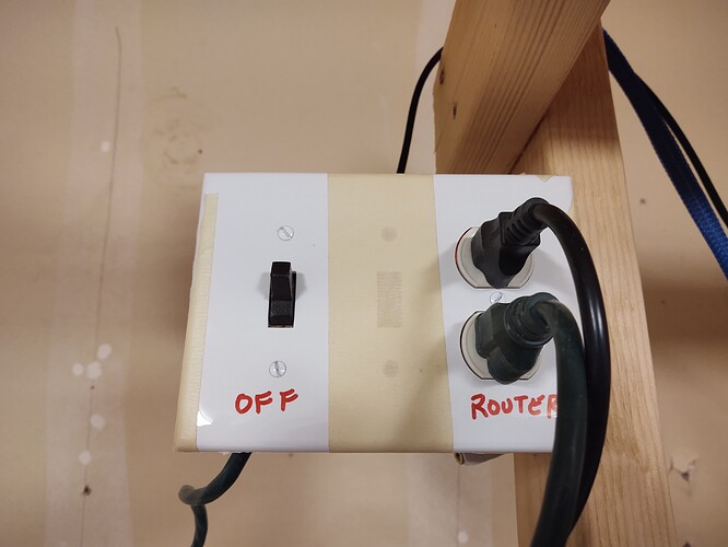

Can anyone help me with wiring this up for router power. I’m thinking cliping the black on cord putting the side from the outlet into NC and the side going to the router on NO. And plugging my Arduino cable into the three pins. Do I have this right? Thanks
I would cut an extension cable and not your router cable. Put the black wire (should have black, white and green) from the wall into the COM(mon) and the black wire out to the router in the NO (normally open) relay connections.
Wire 5V from the arduino to the DC+
Wire ground from the arduino to the DC-
Connect IN to pin Aux 1 I believe
Thanks Orob, your always helpful!

Thanks Orob for helping wire up my router relay. It works great. The switch also works as a Deadman for the router and Arduino.
