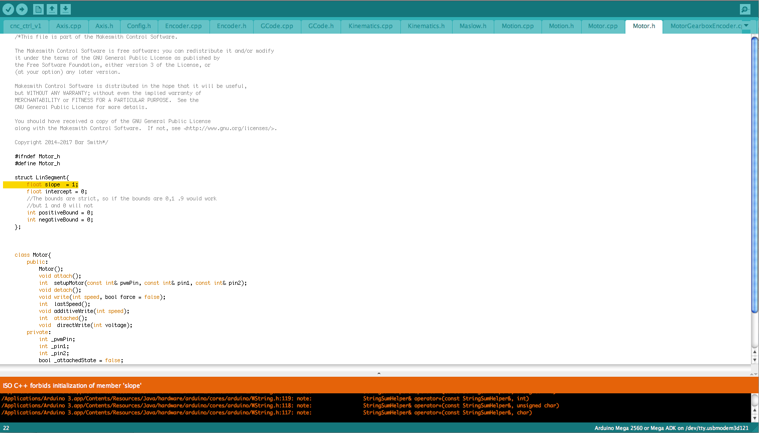

Hi again,
I’m finding the way for import an image so…
When I Download the file
CNC_Control_V1 I have this ( open the picture please)!
I need yours help !!!
if possible in simple english, I don’t speak well !
Tanks you so much
Sloog
Are you running on a mac?
Never seen this error in 2 years.
I would guess that it has to do with the installation of the Arduino IDE.
Can you copy the complete error message from the black window?
What Arduino IDE version are you using?

I just tried the IDE 1.8.9 on macOSMojave and the v1.26 Firmware uploads without error.
https://www.arduino.cc/en/Main/Software
Use the download version, not the web one.
Hi and a big tks,
yes but I’m on old iMac with snow leopard…
for the double post, I was not sure of where is the right place
IDE 1,0,5

I would guess it’s the old IDE.
For IDE 1.8.9 is says mountain-lion or higher. Is snow-leopard higher?
I have trying with differents IDE and allways the same thing
my os is “OSX 10,6,8”
For the IDE 1.8.9. you need at least 10.8

Yes, unfortunately…
I have check if the plugs are wells…I think it’s OK,
Always same problems with the olds mac …
I have the 1,0,5 version, do you think that is the best one for my OS ?
I’m afraid older IDE might not have the needed modules to compile the Firmware, but i’m not an expert.
OK,
tks for all,
I’m going to try the IDE 1,6…? and after, I have a PC with Windows 10, maybe it’s gonna be OK!!
It’s was better to use a used PC but in our world you must buy and buy again
Can’t you update to 10.8: “Mountain Lion”?
That is why i run linux on 10 year old hardware ![]()
NO : frowning_face:
I have check on the web, my machine is blocked just under
good idea
Check part 2: Maslow Firmware
Older versions of Arduino IDE have problems with libraries when compiling the firmware, so make sure you have the latest version.
I have DL the version 1,6 and now, it’s a new message, compilation error
I continue searching the latest version acceptable for my machine
Maybe there is a way to manually update the libraries
