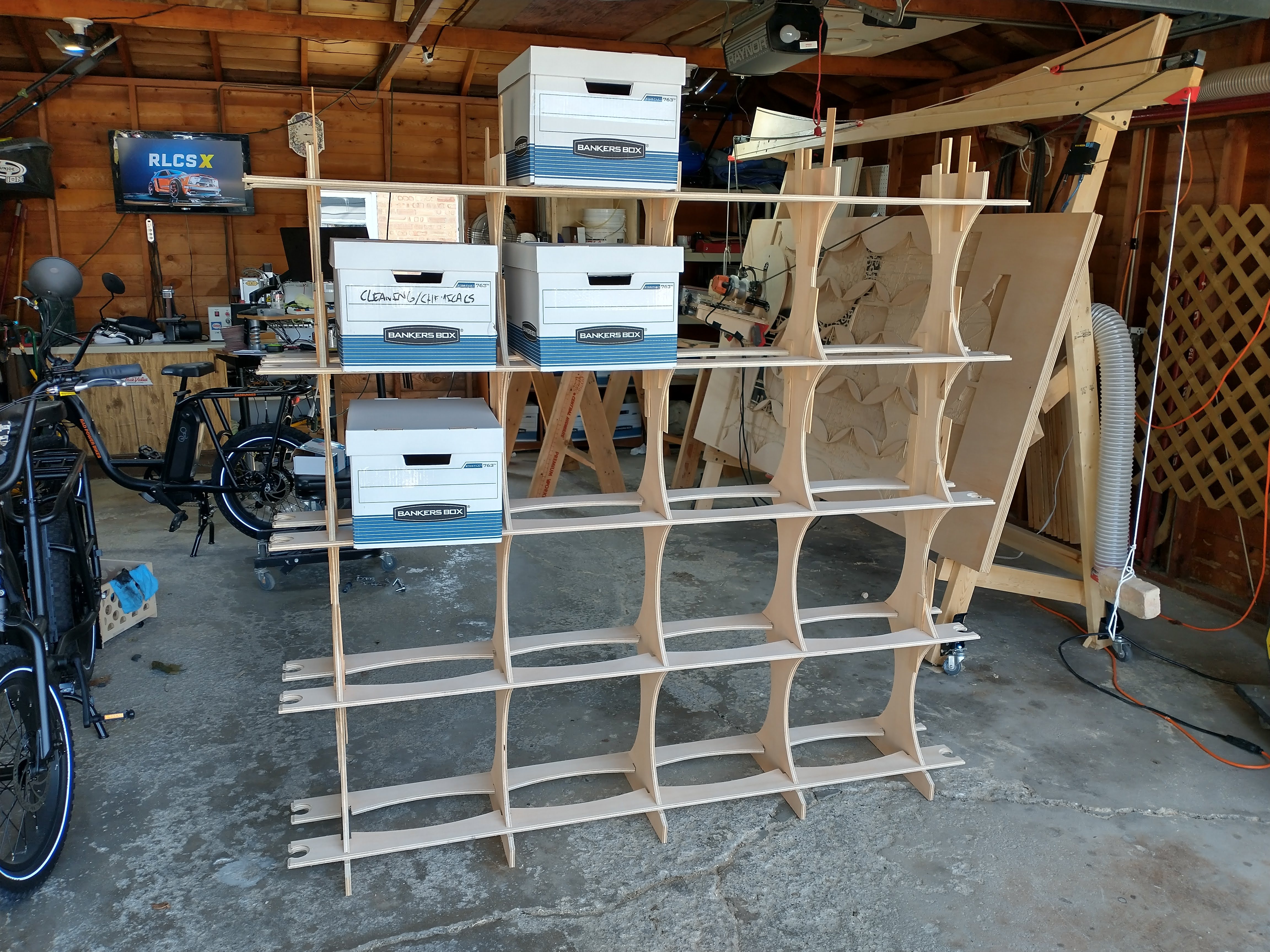

Working on some shelves for lots of bankers boxes. This is how I organize almost everything I own.
This design is attempting to maximize my use of the plywood. I can get one section out of two sheets of plywood but it will be close to the edges.
I’ll also be testing out construction shims as an assembly mechanism. No screws or nails will be used, just shims hammered in place. Straps screwed into the wall will be added to the top to prevent tipping forward.
Plywood arrives this week, should start cutting this weekend. Open to ideas or suggestions.
My only concern with your design is the lack of cross bracing to prevent a side to side collapse. Even with the shims there is a potential for movement. Now if you hard mount the shelves against the wall then you won’t need the cross braces, the wall will function to prevent the side to side movement. How exactly do you plan to attach it to the wall?
I really like the idea of blocking side to side movements using the walls.
I need to make some pieces that will connect the shelves between separate units. Then I can screw the ends to the walls with L brackets and/or make the whole thing so big that it fills the room wall to wall and is incapable of moving side to side. I’ll still need straps at the top to prevent the center from buckling forward.

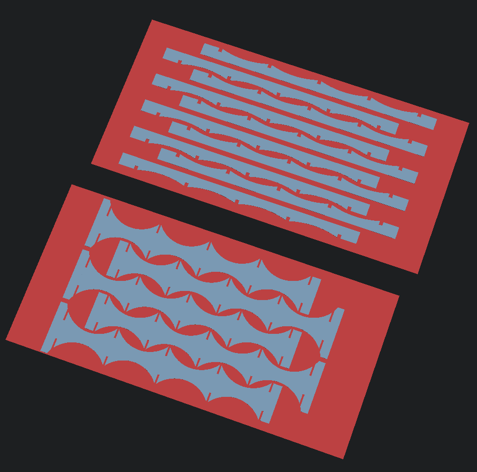

First unit works! The cut was very tight; I’m going to need to predrill some holes to support the middle of the cutsheet or use tabs. There wasn’t enough left to support the parts and I had to hold things up as it went.
The shims are working as I had hoped. It’s very relaxing to assemble and the sheer quantity of joints makes it fairly strong for how little wood is used. When I move it I plan on cutting all the shims in half so they don’t stick out all over the place.
I still plan on boxing this into the room so I’m not relying entirely on the shims for side to side support. I started on a puzzle joint library for the ends of the shelves which will allow the units to be connected and I can make some end pieces to brace against the walls of the room.
There’s a lot of coding left to do but I should have this in the community garden by the time it’s wrapped up.

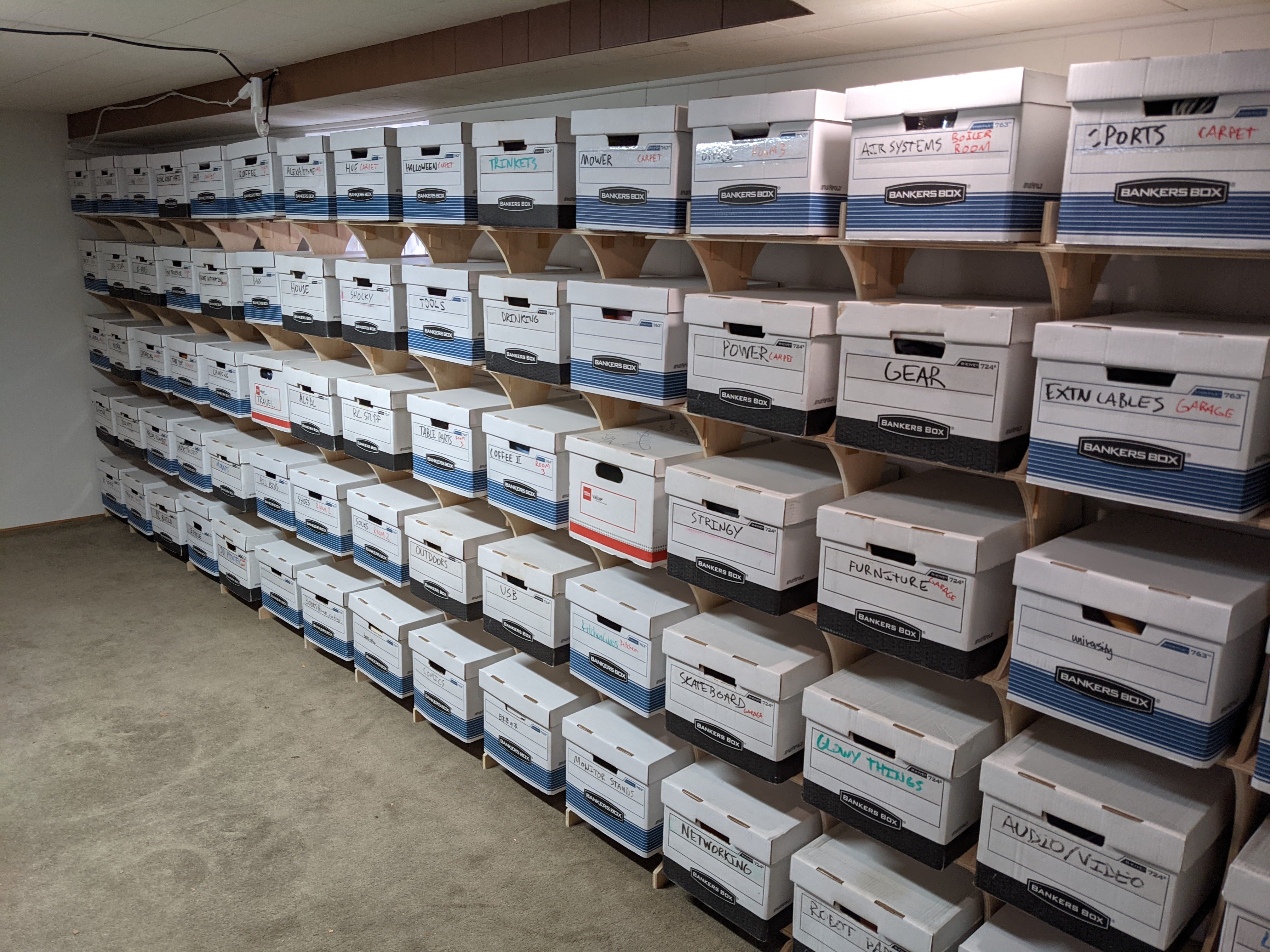

It’s finally done! Wall to wall boxes, all easily accessible. I was worried the shelves would be a little weak because I had packed the parts so tightly but I think what saves it is the sheer number of intersections and how short the spans are.
Total material cost comes to around $300 for seven half inch sheets of plywood and a few boxes of construction shims.

I don’t have it complete enough to add to Community garden but I organized things a little bit.
Some rough instructions:
  • Download all files from src/
  • Open bankers_shelf.scad in OpenSCAD (it’s free and should run on anything)
  • Scroll to the bottom of the file and uncomment the different functions to see individual parts or cutsheets
  • Play with numbers at the top of the file to get it sized for you
  • Render and export the cutsheets as dxf or svg
    • Some cutsheets have dots around the edge for alignment
    • I used SVG output into jscut

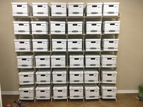

@RedWagon - Thanks again!!! Your OpenSCAD design is truly amazing. It was very easy to modify to change the dimensions and number of rows/columns. Your attention to detail such as including dog-bones is unreal.
One minor addition that would be helpful in a future release would be to include the connector pieces with the two male puzzle joint piece to be in the plywood layout sheets.
I ending up using pocket screws to hold the horizontal pieces to the vertical uprights instead of shims and it worked well.
Also came up with an easy way to tie the shelf to the wall using a 3"x7" piece of plywood with a 2-1/2" pocket screw to a wall stud and 2x 1" screws to a horizontal part of the bankers box shelf.
The final result:
