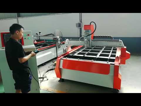

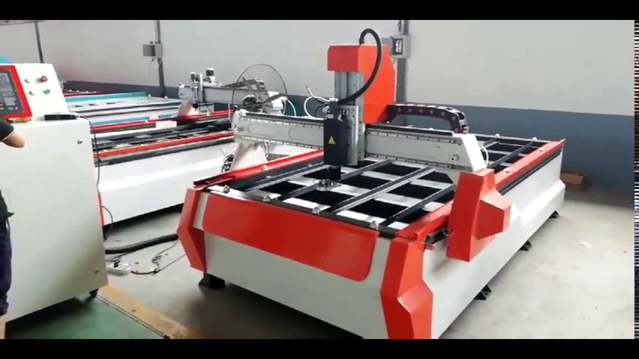

Here is a link to some videos on the new table.
They were taken in the factory during testing. The table is currently in a container “somewhere at sea”, I expect delivery in the next moth or so.
It has been custom built with both plasma and router heads (dual cnc controllers). The spoil-board will fit over the water table.
