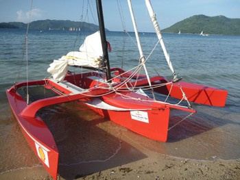

I actually just stumbled across a W17 trimaran kit on sale on Craigslist in Port Townsend, WA. I took a minute to look it up and it’s got some serious promise. First, it’s a kit cut out by Chesapeake Light Craft, so you know it’s a quality product. Second, it’s got a footwell, so it’s much more comfortable for geezers like me than your standard beach multi-hull.
While doing a little research for this post, I stumbled across an image that states it’s the cut file for the W17. Regardless of whether this is an actual faithful representation of the real boat’s parts or not, it’s still a pretty cool concept that 9 sheets of plywood/cut files later, you’re ready to start building your own trimaran. A Weta is the closest thing I know of and they start at around $15K (they’re awesome, I was lucky enough to test sail one for a magazine article).
Another pretty cool feature is that the akas fold inward for docking and trailering. All in all, a pretty interesting package. This might make me rethink the catamaran…
