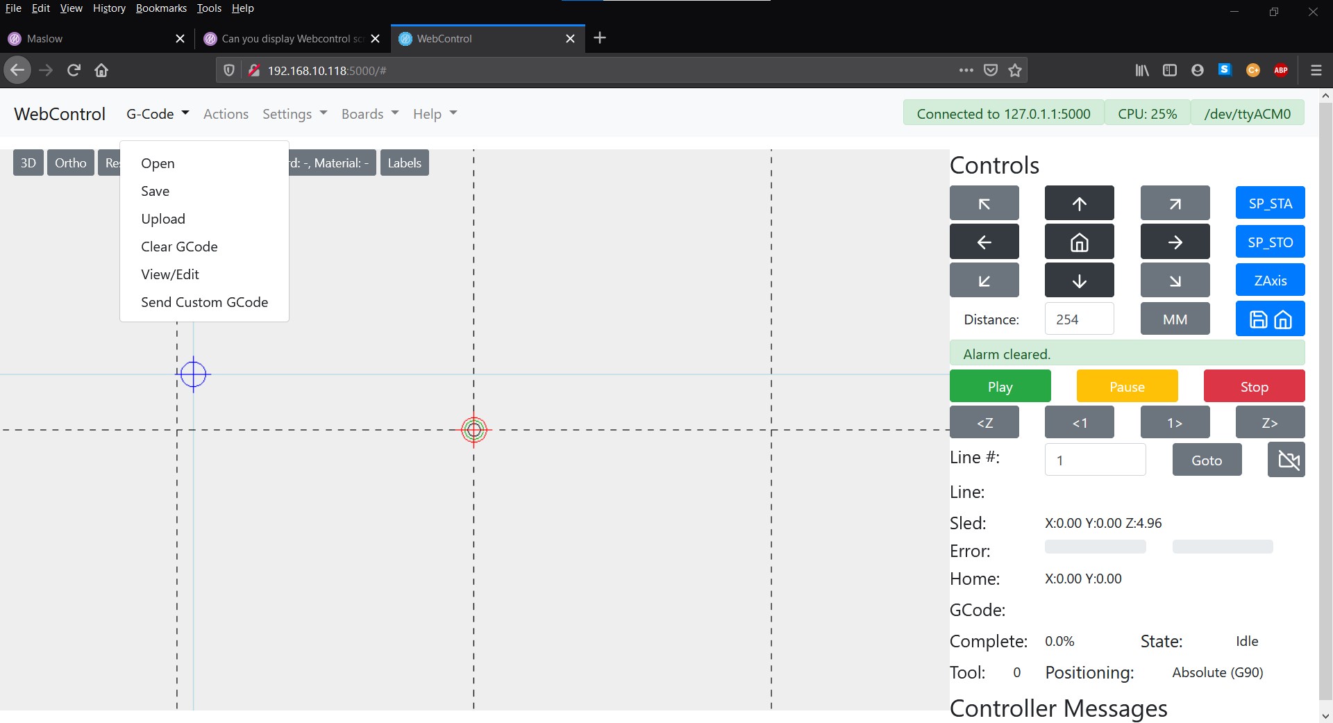

Can you display Webcontrol screen from Rasp Pi when using another computer to control the Router
Yes, once you upload the g-code from the laptop directly to the webcontrol Pi, the file is saved to a lcoal directory on the webcontrol Pi. Even if you clear the gcode from the webcontrol display, the file is retained in a gcode directory for later use. You wont have to upload it again form the laptop unless you need to change the part or otherwise modify the original gcode.
Here is a screenshot of my webcontrol G-CODE menu function:
Under G-CODE, selct OPEN (instead of upload)
You will prompted with the following menu:
If you click on the select file box you will be presented a list of all the gcode files you have previously uploaded. From here you just need to select the file you want and it gets loaded into webcontrol.
For future reference, webcontrol stores all of your previously uploaded gcode files into the
/home/pi/.WebControl/gcode directory on the webcontrol Pi.
Sorry I am back! Now I see what you are referring to, so it really never goes away when you clear the gcode. I never even questioned what the ‘open’ was for. So this way works too, just load 1 by 1 to Gcode from laptop, clear right after…and even if part never run before, it’s saved still. Is that correct? So I do not even need to make the part one, where you click play…it finishes…and then stores. Just load, clear on to the next one? If so this is great and now I understand why you are saying to just do it this way :slight_smile:
Correct.
When you upload a gcode file using the webcontrol menu, two things happen:
  1. The gcode file is copied to the /home/pi/.WebControl/gcode directory of the webcontrol Pi
  2. The gcode file is loaded into WebControl.
You could do it the way you mentioned
You could also manualy transfer the gcode files to the webcontrol pi /home/pi/.WebControl/gcode directory using your laptop and WinSCP if you wanted. Then you could just open them with webcontrol as described previously.
