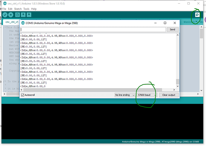

Next let’s try to get it to send back information from the firmware. After uploading the firmware if you click the magnifying glass in the upper right corner and change the baud rate at the bottom of that window to 57600 you should see the machine reporting it’s position. What do you see there?

Once it finishes uploading click the square in the Upper right corner as shown in the picture below.
This will open the terminal window and should display a random group of numbers. If you are not seeing the numbers check the communication speed is 9600. This is shown in the lower right of the terminal window. It has a pull down if you need to change it to 9600 baud.
The goal is to get the window scrolling numbers.
Tell us what happens.
