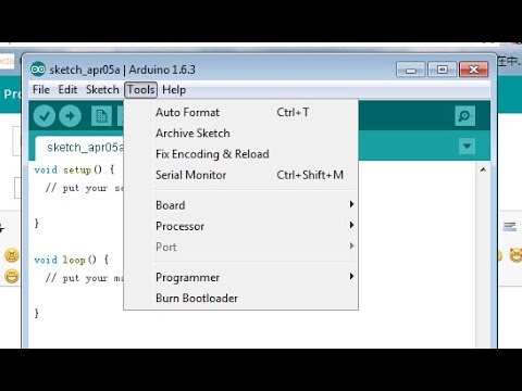

Different from the tutorial is the board selection.
You select the Mega like in this pic:
A visual confirmation that you are ready to upload the Firmware is the check-mark on the port.
One more is in the bottom right corner.
