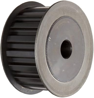

Instead of discussing theoretical setups I’ve chosen a pulley I’d like to know where to change the information in the firmware or in ground control?

Martin Part number 22XL037
Martin DF-1 Style Timing Pulley, 1/5" Pitch, Extra Light, 1/4 and 3/8" Wide Belts, 0.25" Bore
Is that all the info I need?
Here’s the link if anyone is interested.
I am using the Maslow stock motors and I am aware the bore is wrong but I’ve got that covered…

you also need the number of teeth on the pully
That looks good to me. There are a couple settings you will want to change (mostly number of teeth and the pitch between notches on the belt) which Ground Control will use to calculate the distance moved per rotation.
If you have any trouble with the settings when you have it all together let us know and we will be happy to help!

Here’s what I got for timing pulleys…
Specifications
Number of teeth: 22
Outside diameter: 1.381 in
Belt width: 3/8 in, 1/4 in Material: Cast Iron
Pitch: 0.2 in
Length through bore: 7/8 in
Bore diameter: 1/4 to 3/4 in Face width: 9/16 in
Flange outside diameter: 1.63 in Pulley construction: Plain
Pitch diameter: 1.401 in Number of hubs: 1
Belt type: XL
Hub diameter: 1 in
Bore type: Rough Stock
Hub projection: 5/16 in
With flanges: With Flanges
Sooooo, that MUST be EVERYTHING, right? Has to be…
