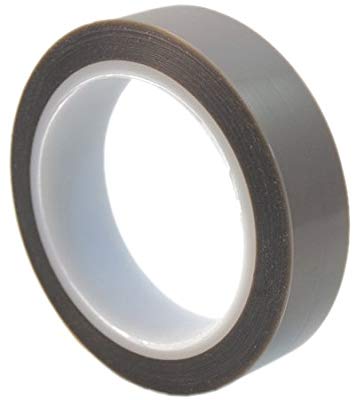

Also consider low-friction tape between the router base and the spindle.
UHMW (polyethylene):
PTFE (Teflon):
(These are random examples. I have no connection to Amazon or these products)
I’m using a version of the upper one on the spindle body and housing. It works, and I’m happy to use it because oil + sawdust didn’t seem like a great combo. Your need to use a screw and nut to hold the housing slightly more open, it’s not made with enough tolerance for 2 layers of tape. Also make sure the ends of the tape extend out of the housing and to the outside, or eventually the spindle will start peeling up the edge and jam in the housing.
