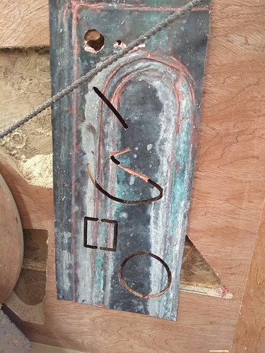

Some experimenting cutting metal for the first time. I have these old reclaimed copper sheets that I was able to cut some basic shapes into mostly successfully.
I then got the ammonia and salt out and made it blue.
Had a go with a V-bit I got in a set and hadn’t used before.

Which led to this…

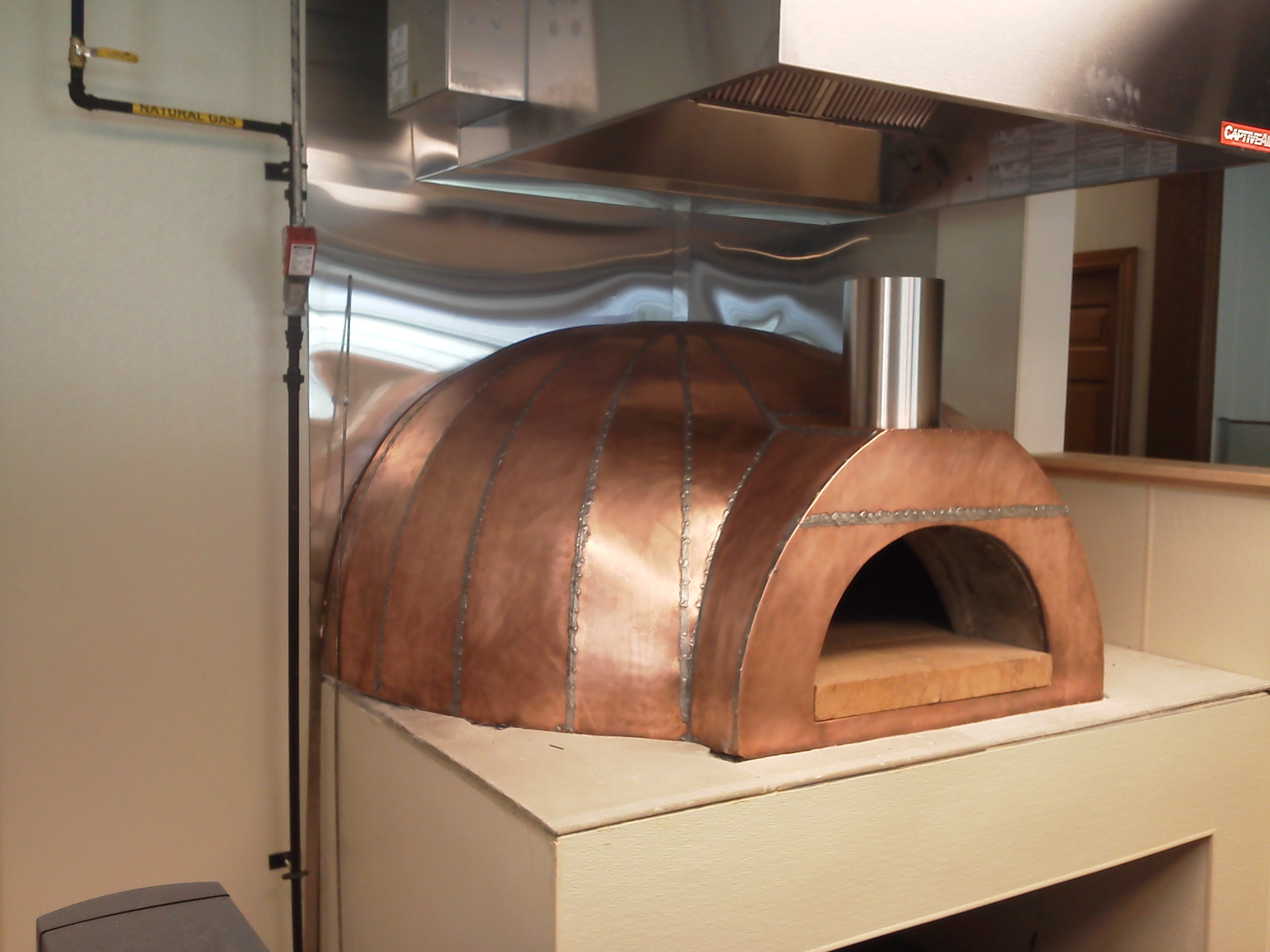

Pizza oven?
