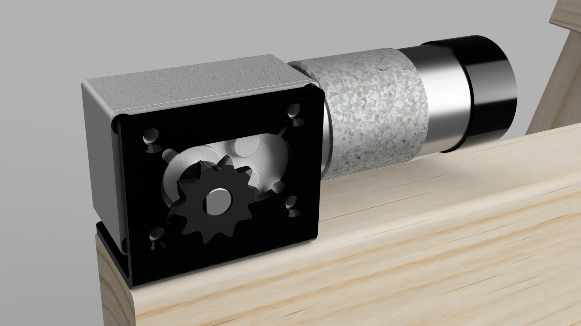

I feel bad creating a new thread for this. I have another request for the critical dimensions of the XY motor mount.
How high does the shaft sit above the main beam and whats the offset of the gear from the mount?
There are Sketchup files of the motor brackets in Mechanical/Hardware - would those help? The gear would be adjustable along the length of the motor shaft, but typically located at the end away from the motor body.
Thanks blurfl,
I see some discrepancies between the sketchup model and the “WORM+GEAR+MOTOR+MOUNTING+BRACKET+FOR+GW31ZY+OR+GW370” drawings.
Nominally, the sketchup shows 29mm from the base to the centerline of the motor
And the amazon/ebay drawings which show 30mm. Anyone knows which the official kit uses?
WORMGEARMOUNTGW31ZYGW370
Working on the motor right now. Does anybody know the length of the encoder past the motor end? I guessed based on pictures. I used the sprocket dimensions from superdroidrobots since it looked close to the original.
