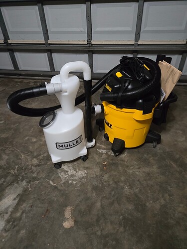

Speaking of dust collecting, I am looking for the actual ID / OD dimensions of “The NOT Shop” dust collectors. I have a new Dewalt Stealthsonic shop vacuum (super quiet BTW!). The hose I have appears to measure 2.25 OD and 1.98 ID at the outer end, with a slight taper to larger on the OD, so I am assuming the 2.31 dust collector is what I want to print, but would like to confirm that actual design / printed part dimensions if anyone has that?
Are you satisfied with the Dewalt Stealthsonic shop vacuum?
The main parameter for me in the noise. Is it noisier than the Maslow in action?
I am very satisfied with it. Unbelievably quiet and still very powerful. I paired it with a Mullet cyclone to “pre-filter” the dust and it works great, and so far no dust has made it past the Mullet into the vacuum.
It is a lower pitch and far quieter than the router. I can stand 3 feet from the vacuum when running and have a conversation without having to shout or even raise my voice.
