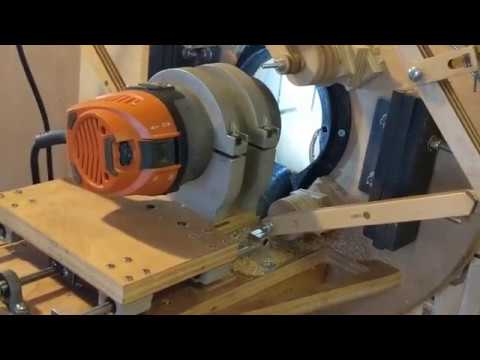

I finally got my own machine cutting again! :tada:
I’ve finished up my new 12’ top beam and implemented my own Z axis. Even on just my first project, I’m beyond happy with the improvements. Z axis movements are so smooth, and it moves much faster than it used to. I still have yet to even really push it as far as axis speed though, my current gearing is pretty mild.
Here’s a short clip of it in action:
Still need to get my dust collector working again, I already made a lot of chips with it!
