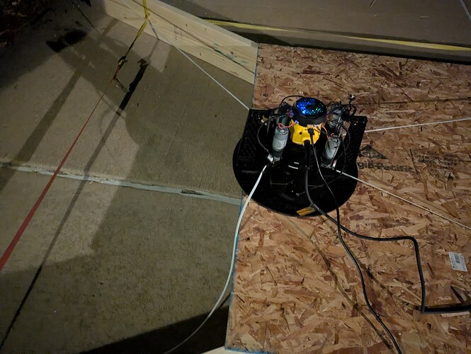

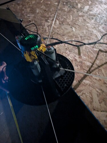

Fell of the top of the board then belts snarled inside the spools
Made a new frame, smaller than the others. roughly 4300 by 2300. May try to make it taller and less wide to get a better cutting area. Calibration took about an hour? and with a calibration grid set at 400 by 400 5x5 it finally worked but the calibration grid top row was about 10cm off of the top of the plywood. I saved it by holding it up with my hand. Is there a way to set the calibration grid to be centered on the original position? Here is the log in case that helps make sense. I tried to visually center it and then reset the xy home to that point. I had read in some of the forums that it might be possible to manually describe the frame size as an estimate in order to speed up calibration? I don’t see that on the config dialogue. Where would that be? Happy that i can finally drive my machine around using the buttons. Yay. Perhaps I’ll try some practice movements tomorrow.

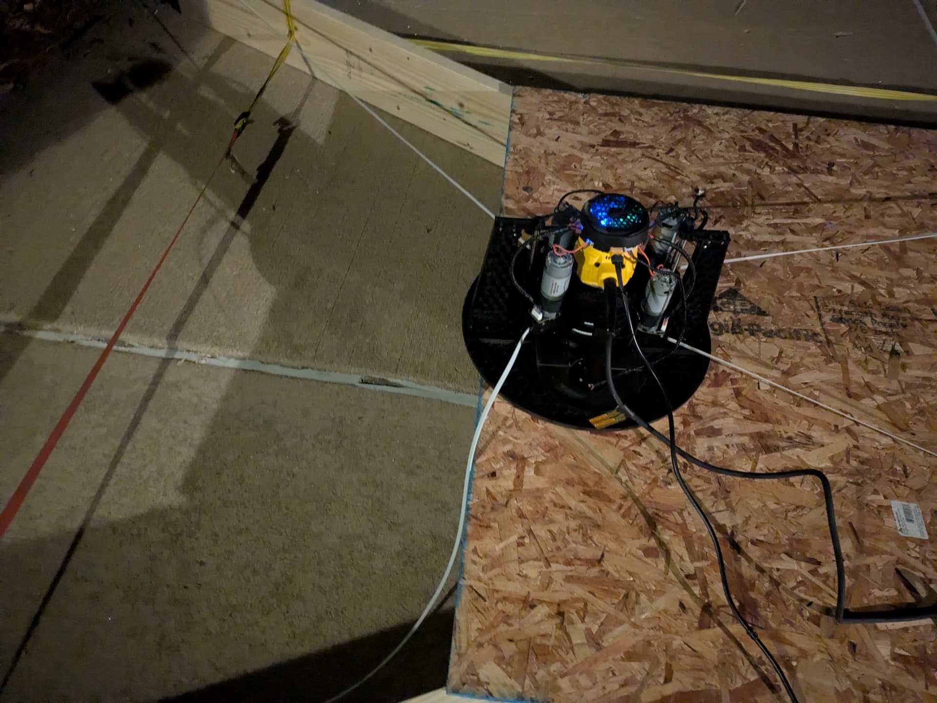

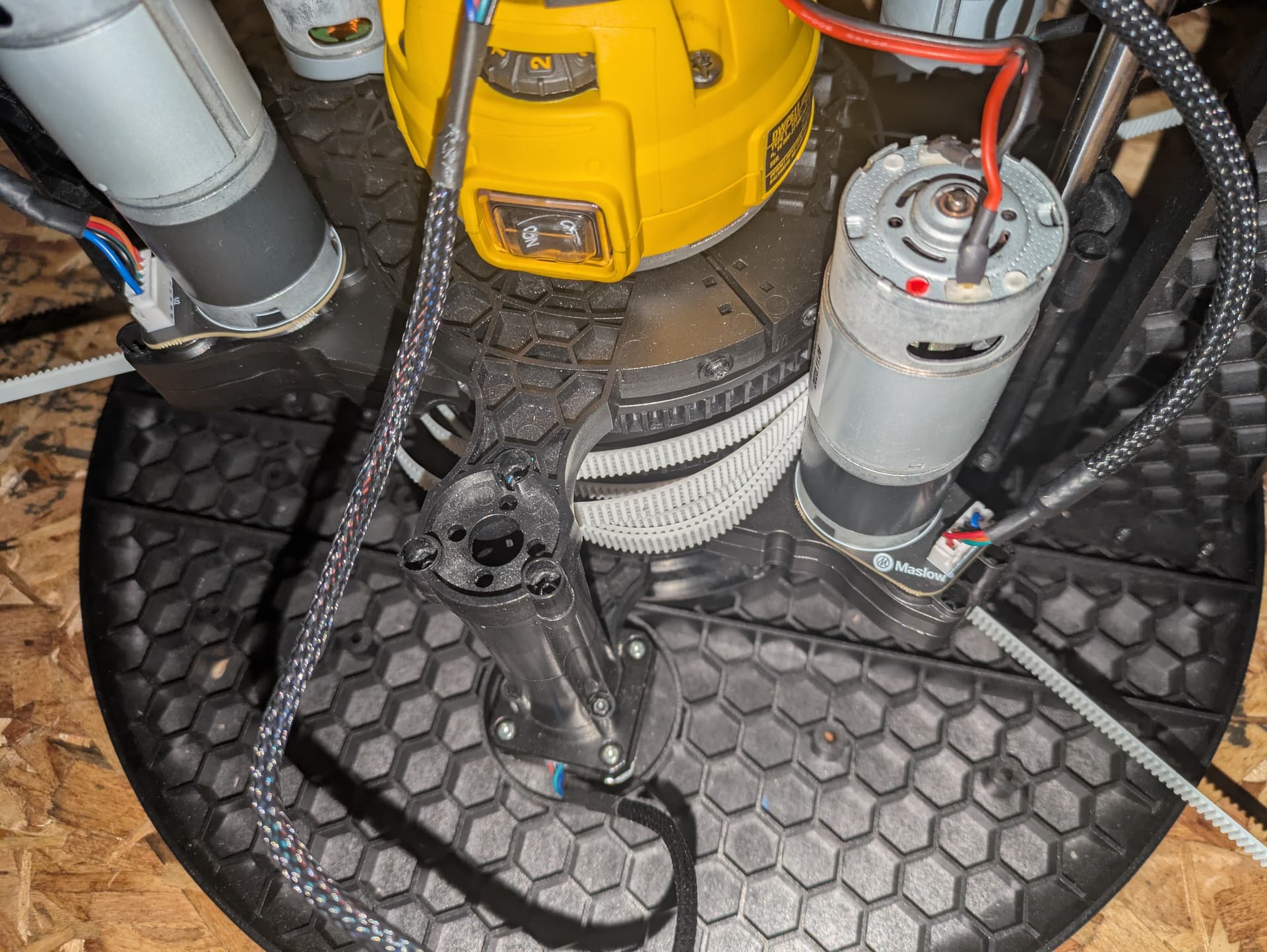

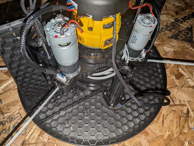

New problem. I was driving it around the board for fun and when it got to the corner and the shortest belt had about four inches of slack. I tried to pull it out of the spool and things looked ok but then when I drove it back to the center the two middle belts became fouled on the spools.
Pictures and logs. No idea what is happening. Just got it working and was driving it around just a little bit.

the calibrate routine starts with all belts very close to equal lengths, it
currently need to calibrate around tht point. once it’s calibrated, you can
shift your workpiece as you want, but for the calibration, you need a surfact
the size of your calibration grid + ~150mm one each edge (+300mm total) to keep
the sled from falling off

the fact that slack developed indicates that your calibrtion did not go well.
the good news is I do not see any sign from your pictures that the belt has gone
through the gears
what you are going to need to do is one of two things (neither is very easy)
the safer way is to disassemble the arms and get the belt straight and
reassemble the arms (if you do so, check how smoothly things move, lube them
while you are in there)
the ‘faster’ way is to take advantage that there are some loops in the belt (and
therefor a tiny bit of slack) move the slack around until you can get all the
belts aligned, even if loose. Then you should be able to run the motor.
there are commands that you can send (via the fluidnc tab where you can type in
gcode, via USB from a terminal program, or via telnet to the maslow
TLO will feed the TL belt out just a little bit (unless things go wrong and it
spools out fast, forcing you to pull the plug)
TLI will retract the belt a little bit
ALL is the same as the retract-all button and will spool in all the belts.
when you run the motors, you need to make sure that parts of the belt that are
sticking up do not go through the gears. This is what makes this way less safe.
When I went through theis a couple days ago for the first time, it took me and
hour to coax the belts into a clean setup, extend them all the way via TLO type
commands. the 10th or 12th time it happened to me this weekend (when you are
doing development work on the firmware, bad things can happen) it only took me
about 10 min for a worse snarl.
to keep your sanity as if you take the second approach, keep reminding yourself
that the other option is to tear down the machine to get the arms out then
disassemble the arms :-/
one thing that I’m finding is that when the belts get in trouble like this
(spooled out a lot) pulling on them can be a really bad thing to do.
unless the belts are folded back on themselves, or so jammed up that they are
already out of line, just hitting retract all will probably solve the issue as
it pulls the belts in from the center, and by the time the outer layers start
moving, the other belts are out of their way and they can spool up correctly.
