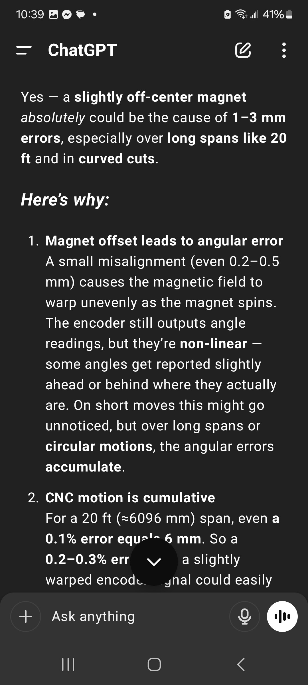

What about the ‘centeredness’ of the encoder magnet in the little plastic thingy. There is quite a bit of room for play, so perhaps the position that the magnet is glued throws off the readings ever so slightly.
I’m no expert with the components of the M4, but I believe this is the same encoder.
.25mm would be tough to keep consistent I’d suspect.

Like David says: The fit of the magnet in the pulley and the pulley in the bearings in my kit was fairly tight. Of course there might still be an offset and there are other factors contributing to this, too, like PCB placement or even slight shifting of the sensor on the PCB during soldering. So let’s assume a 20-teeth pulley (I don’t know the actual size, but it’s the right ballpark). Then a 2.5° angular error translates into a periodic 0.28mm belt extension error.
Note that this is not cumulative, contrary to what ChatGPT suggests, because we know that with each full revolution of the pulley the belt is moved in or out by a certain number of teeth.
How large the periodic encoder error is, can be determined by @bar while extending or retracting the belts. With constant motor speed he should see a periodic modulation on the extended belt length with a cyclic duration of n*2mm where n is the number of teeth on the pulleys. In fact, once this modulation is measured, it could be corrected for in software and the correction values (amplitude and phase shift) stored in the maslow.yaml file.
Nevertheless, I believe that other factors contribute more to the cut accuracy. Otherwise, we’d see wobbly straight lines all over the place.
I played around with this a fair bit early on, but I found it didn’t make much difference.
What I was trying to do was to create a linearization function which would run the motor at a constant speed and then monitor the encoder position. If the motor is running at a constant speed but there is a periodic variation in the speed measured by the encoder then we know the magnet is misaligned and we can compute by how much and in which direction and correct for it.
In my testing I found that it was a very very small variation and not worth the extra complexity of adding a step to the calibration process.
That’s what I expected.
