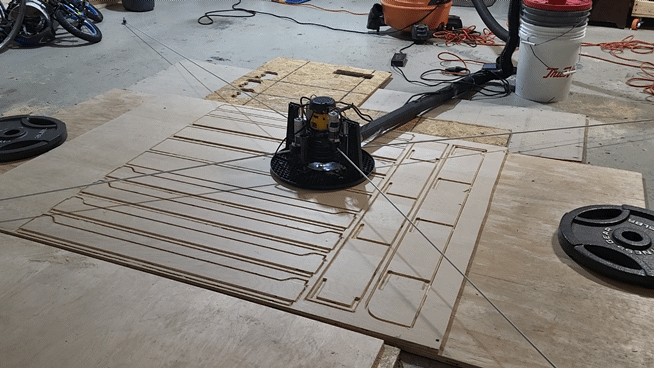

I built a bookshelf for my toddler, modeled after designs my wife liked on Etsy. I designed it in Onshape and used Kiri:Moto for CAM.
Some dados were perfect, but others were slightly tight in spots, so I widened them with a chisel and table saw. I noticed dados cut in the Y direction were spot-on (up and down), while those in the X direction were a bit undersized.
Learned a ton along the way—excited for the next project!
