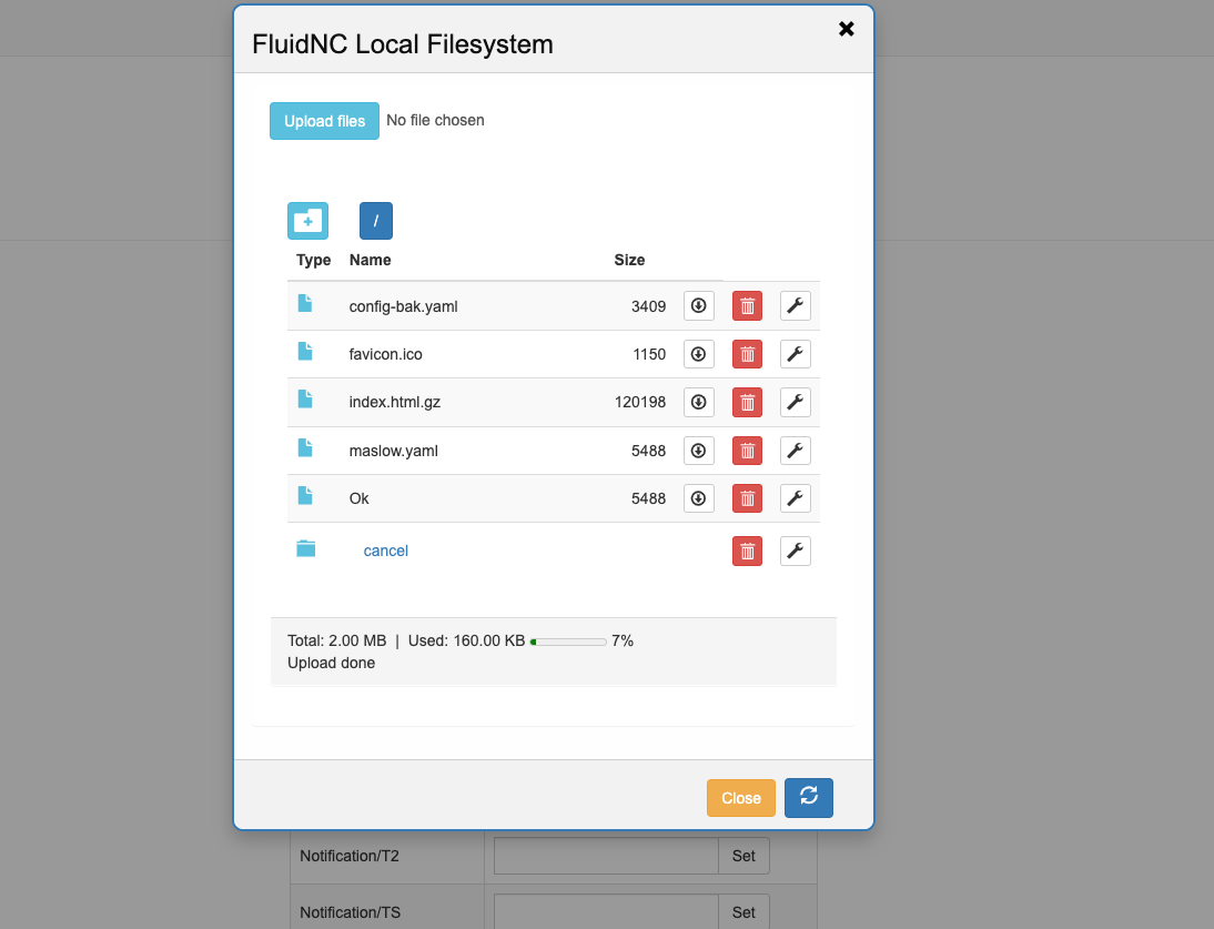

Quite amusing (because I was able to work around it) bug.
I’ve not fully checked I can repro from a fresh flash but I believe all I did was:
  • Full Flash 1.05 from Windows on top of a fresh from factory 4.1 board.
  • Try config and have it fail (don’t think it’s related).
  • Power cycle
  • Attempt to rename / modify files on Android 12 running Chrome 136..0.7103.87 connecting via Maslow-self-hotspot.
Soooooo when I did this, if I tried to rename a file (ie maslow.yaml → maslow_bak.yaml), it instead renamed it to ‘Ok.js’. File itself was unchanged so it appears it’s pulling the string for the button name rather than the text field.
And I tried creating a folder and canceling that and it called it ‘Cancel’ (maybe .js I forgot to check).
I wonder if it’s related to:
I wasn’t able to delete the folder, but I also bailed from trying to work around it on my phone at that point.

I have run across this and have been able to confirm using window 11 - Chrome
I am able to replicate this too using the edit file name tool:
It seems like the culprit is these two lines here:
const creditsDlgCancel = () => closeModal("cancel");
const creditsDlgClose = () => closeModal("Ok");
We should be calling the closeInputModal function instead.
Here is a fixed index.html file. The fixes will also be in the next release.
index.html.gz (117.4 KB)
