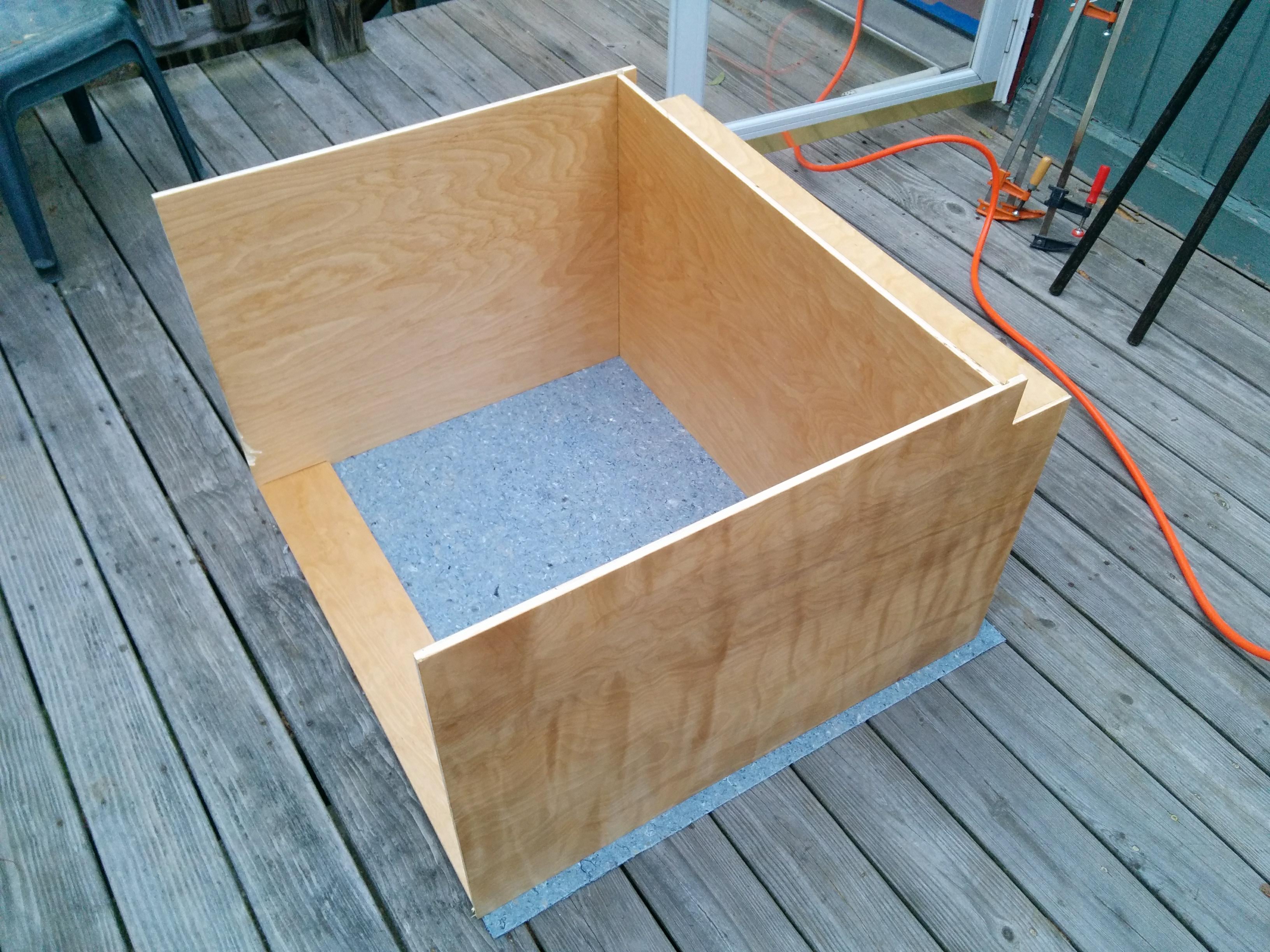

I got the cabinet ends off the Maslow on Saturday and cut the remaining deck, nailer, and toe kick. I gave everything a light sand and then applied 2 coats of tung oil to each side. I was able to save the doors and face frame from the original melamine sink base that we bought with the set, so I simply reused it. Here’s each of the parts lined up before I assembled everything:
Then we assembled the components. First we built the plywood case. I quickly brad-nailed all the parts together once everything was glued. I wanted to clamp everything together first, but most of my clamps are still at my old apartment (which we’re getting ready for the final move).
Once I was happy with the case, we glued on the face frame, and clamped it in place. Once it was assembled, I had to route out a passage in the left end for the dishwasher hoses and power cable to pass through. If I had been smart, I would have had the Maslow cut that out while it was already making the part.
