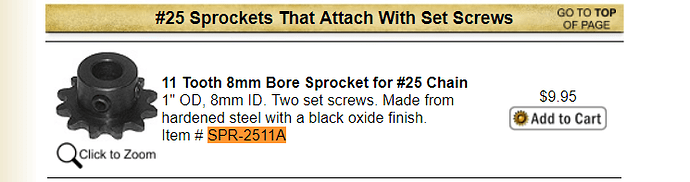

The chain is #25 from Amazon. (pitch .250inches)
The sprockets on the left and right motor shafts are #25, 11 tooth. (https://electricscooterparts.com/sprockets25chain-motor.html)
Wrong chain?
I’m not an expert, but the distance per rotation might be a clue. In the groundcontrol.ini -> distperrot = 63.5. You could use the ‘set sprocket to 12’ from the calibration to rotate a full turn and measure the chain feed.
Have you changed the value of Settings/Advanced/GearTeeth from the default 10 to 11? That could make a difference…

Suspect this is a circumference of the sprocket issue.

After changing Maslow Advanced settings tooth count to 11, my accuracy has improved.
Ground Control’s calculated value is at 3136.58mm and my tape measured value is 3146mm (different from my first measurement due to me messing it up).
Is it good enough to be off by 10mm?
no, override the calculated value with the measured one.
This is common, we know the cause, but have not figured out the proper fix for
it.
