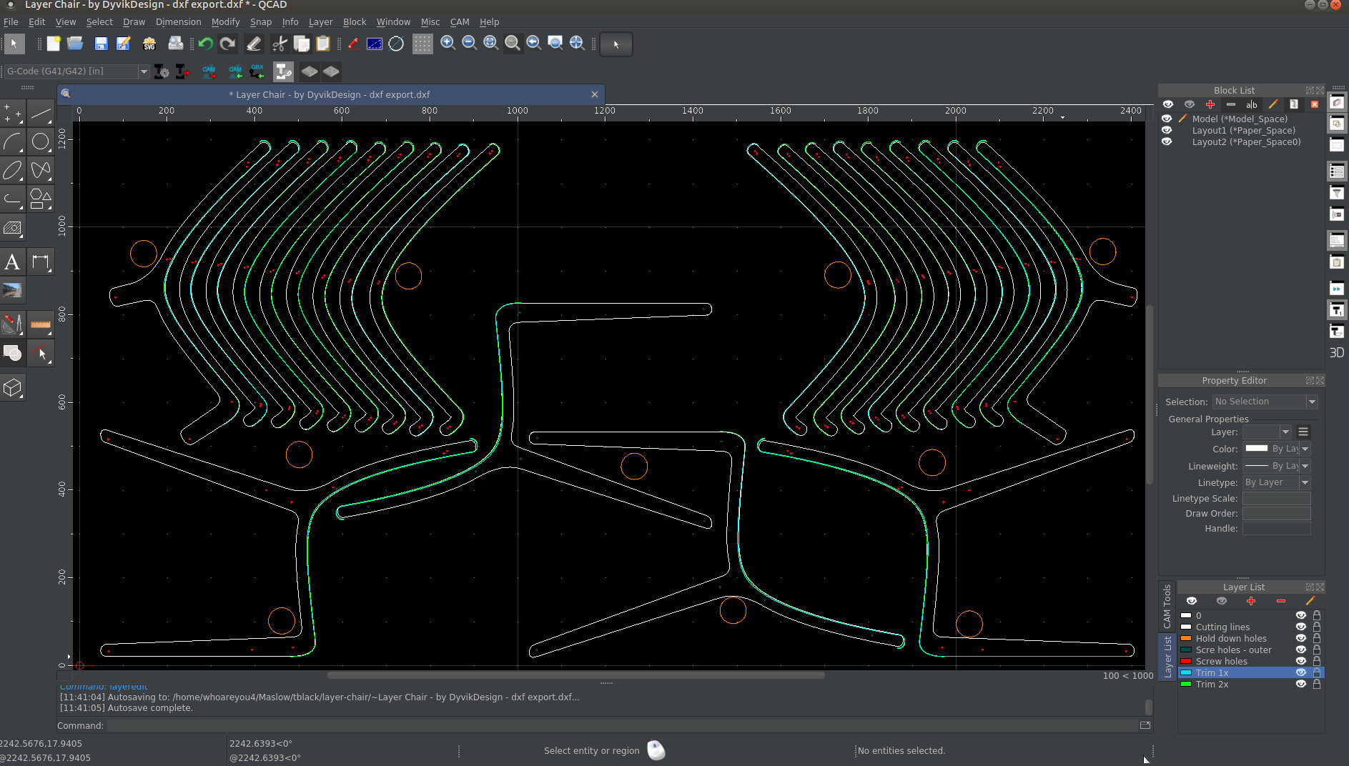

I’ll post a screenshot shortly. The only thing I can think of what those trimline could be for is for a rounding bit or so. They are not on all parts. The one layer called ‘cutlines’ and the layer ‘screwholes’ should do the trick, is my guess. The layer ‘holddown’ holes is not needed.

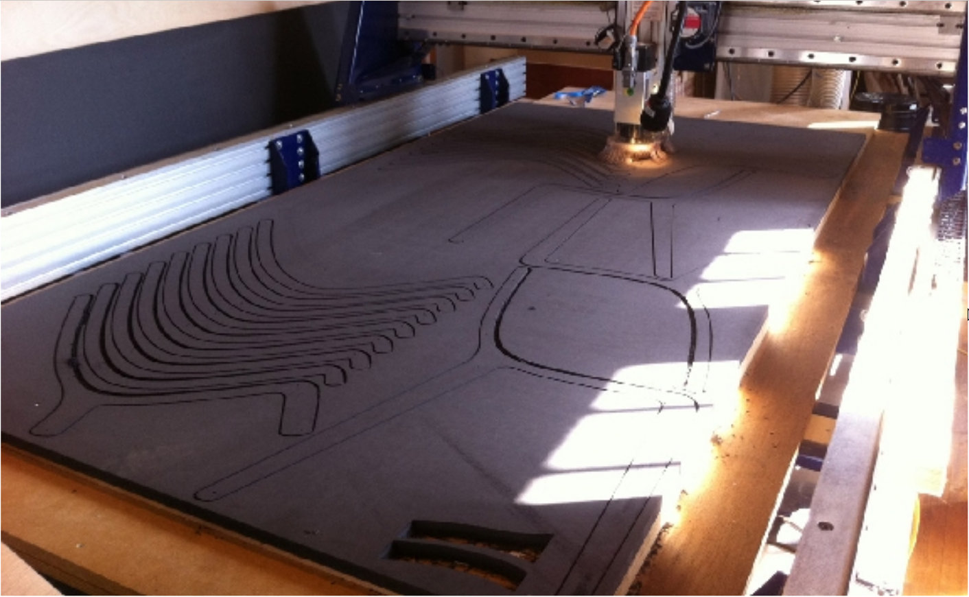

The cutting bit diameter is specified in the fifth photo (screenshot) as 3.18mm, which is most likely the metric representation of 1/8". The MDF is 18mm thick, and the extra cuts are made at 6mm and 12mm to get the effect you see in picture three.
I expect the drill holes are 1/8" too, since it makes a lot of sense to reduce the number of bit changes. Plus the BBQ sticks they are using as dowels are probably around 3mm diameter.

I really think those lines are for the stepped edge effect as shown in the third picture.

YES. I only deleted the ‘holding down holes’ layer and stored as R12 dxf and then DXF2GCODE would load it.
Ony problem is that Qcad turned the 6.3MB file into a 58.8MB file, so you need to go and take a coffee until it is loaded.

- Which one of the trim cuts is 6 and which is 12?
- Are these bit changes or depth changes?

In picture three you can see that the pieces are all stacked up to make the chair, but they are angled/offset, so the extra ‘stairstep’ cuts make the edge ‘flatter’, otherwise it would be a very coarse ‘sawtooth’.

The material is 18mm MDF, and the bit does not change (it’s 1/8"), so looking at the picture I am guessing that the top ‘stairstep’ is 6mm depth, and the middle step is 12mm. Obviously the full cut is 18mm, but probably you’ll have to do that in several passes anyway. In fact, with the rule of thumb that you should cut to a depth of half of the bit diameter, this is going to take a while. You might get away with a 6mm cut in one pass, then the top ‘stairstep’ is one pass, the middle one is two passes, and the full cut is three passes.
As to which trim cut is which, well it looks like picture three is taken from the top down, so you could find the outermost piece in the CAD drawing and look at the layers. The complete outline will be the full cut (18mm), and probably there are two lines that overlap the outline for the back and the seat, but not the legs. The innermost line would be cut to 6mm depth, then the other one will be 12mm.

I too both looked at the original design and noticed the multiple steps in each cut segment. These steps allow the segments to be offset from each other and still provide a somewhat smooth interface to the body(human). Otherwise there would be larger corners sticking out as the author intended for there to be a curved effect.
Given that, I loaded the dxf into freeCAD and it didn’t look good. Took forever to load in bCNC and it too didn’t look like I could see many of the lines. But importing into Inkscape I could see all the lines and as mentioned, the offset cuts were there as separate splines and probably require a different diameter bit to get the effect. A different way to do it than a single bit and letting the cnc machine make multiple passes to get the effect.
Have you looked at what it takes in Inkscape to generate gcode? That’s how I would approach this. Figure out how to define different toolpaths and then start updating the design colors or layers so that Inkscape can generate the tool paths for the different parts of the design. It sure looks like all the parts of the design were imported.

for a while, just did not have a file that would get me started. Have it now. Thanks!
