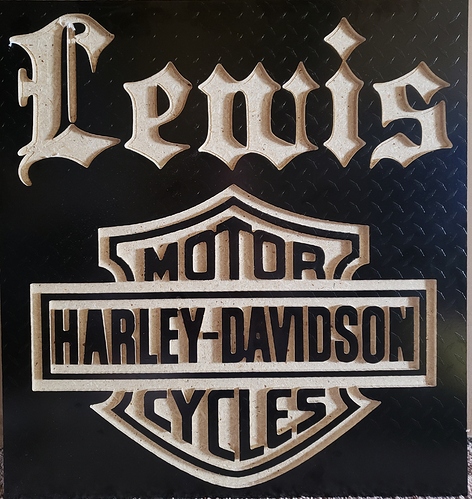

Final note, do you have a picture of that first project you did, I am so curious!
@ChrisB The only issue i had on it is the bit was too big to cut the center of the a’s. I’ve tried the updating gcode and it’s made my cut go off. I’ve also tried the breaking up the gcode and have had worse issues with it. I kinda stepped away from it and moved on to my X-Carve and have had not one issue with that. I’ve run really really long code and it’s completed project. I can cut simple items on maslow that finish fairly soon. Now I’m having the router pop out and bit dragging, so I’ve done the fix with bushing glued to it but have not tried it since i fixed it. I also bought stuff for auto z-axis, but haven’t installed yet because i can’t get a definite description on how to program it. Im not that savvy to enter numbers in program and i think people on here don’t wanna go into long explanation or pics on how to do. I’ve read all the info on here about it but still kinda lost with it. So as i said i moved on to my X-carve. As i can probe on that and don’t have any issues with bit changes with it either. I would love to get Maslow up and running as good, I just need more help on the auto z and the programming the button to run auto z. Thanks for your reply.

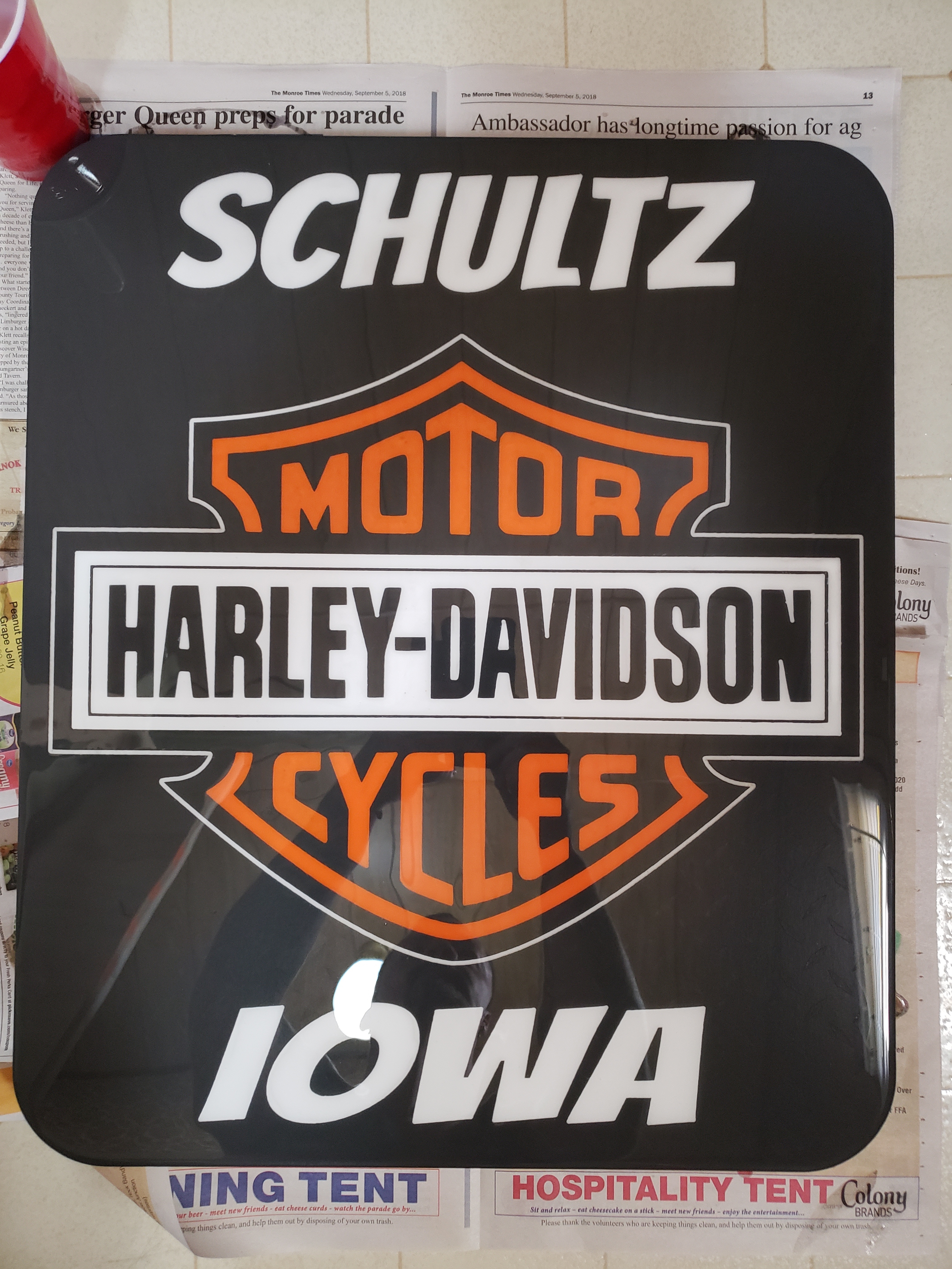

@ChrisB This is one i just finished for a friend. I did it on my X-carve though. Filled it with epoxy with pigments and then clear epoxy over that. You got a link to that z motor upgrade for parts? I’d like to do that as well, it’s so slow and really adds a lot of time to the job. You will like the auto z feature. So much easier, especially with bit changes. My bit drag was a gcode issue i think. It didn’t even try to raise bit, i was watching when it did it and i pulled sled up, but it was too late. Lol :confused:
That looks awesome. Here is the link to the whole forum (If you have some time for reading) Then here is alink of the motor that I purchased off of amazon, I think my first one was just a bad encoder. But I would suggest just cutting off their plug, do not try to do what I did and un-solder from the encoder.
