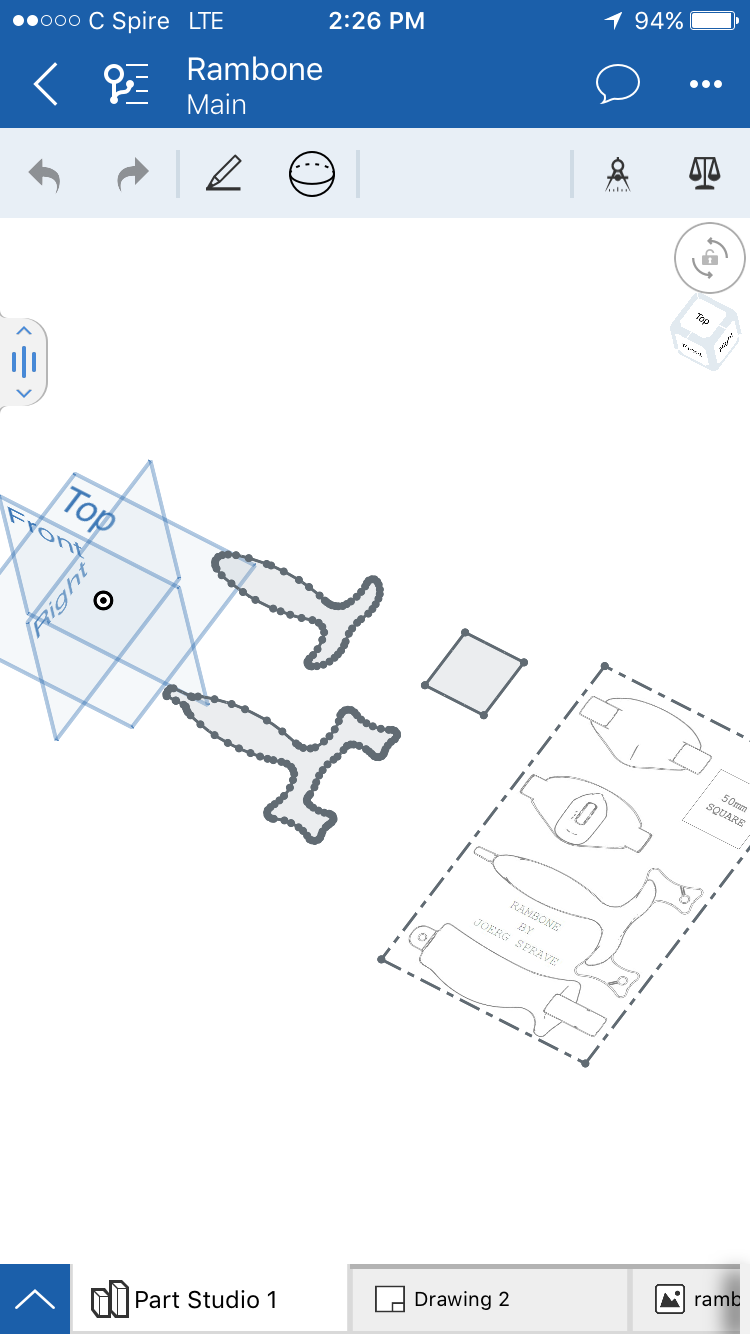

So I went back and watched the video Bar posted on YouTube about doing this conversion. Still couldn’t get my file to work. Then I noticed that one box in my export drawing box was “Export as text”. And the one that was on the YouTube video was “Explode into Polylines”. I made this change and I still get the same message.
So I tried creating a simple circle and square, then exported them to a DXF. This file opened in Inkscape.
I figure there is something I need to do to clean up my drawings to make them work. I just can’t figure out what to do?
A little back ground on the drawing(s) I am trying to export. I loaded a Picture into OnShape and traced the parts off the picture. Then suppressed everything after that. Then Exported the file.
IMG_2919
IMG_2920
Any thoughts on what I need to do to correct this problem would greatly be appreciated.
