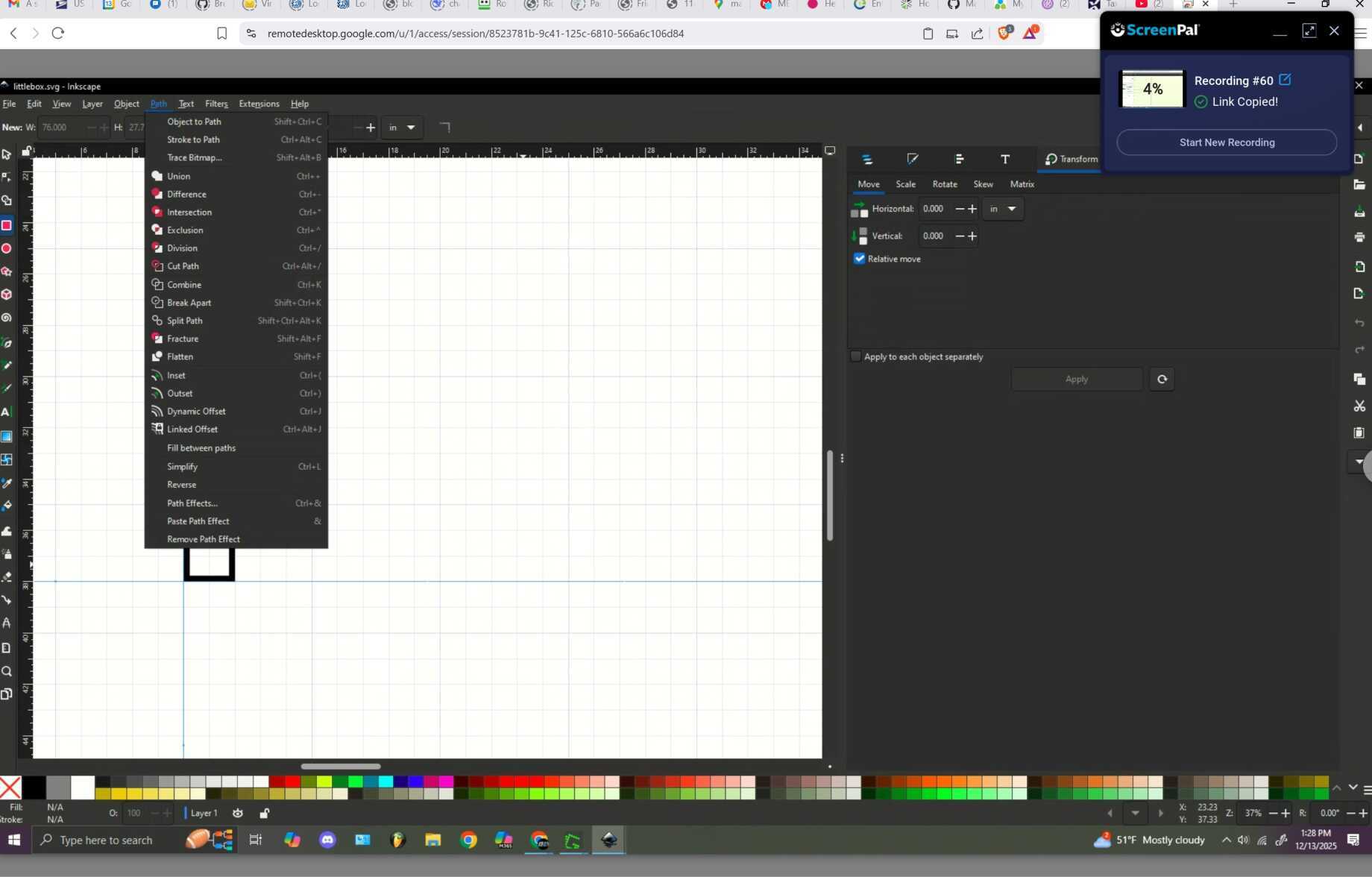

I’m still learning about all this but I think skipping your own svg generation is a good way to start… You can actually make cool shapes right within krabzcam. Made this video for you:
Once you have actually cut some shapes sucessfully you can create and import your own designs into krabz. Here is an example of saving an svg in inkscape and importing into krabz:
Inkscape to cnc tips:
Generate toolpath with Krabzcam
thank you i really appreciate the videos, i downloaded inkscape after affinity kept messing up and it worked much better i just gotta figure out why it made such a big area around it
