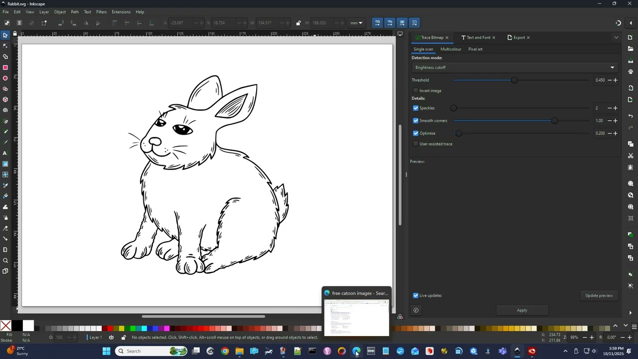

The following is a short demo of getting a drawing to cutting a shape.

Do you set the size of the Rabbit in inkscape or in Krabcamz?
You can set it in either. I like to get it the right size in inkscape, when you draw things there you can use coordinates and specify sizes exactly. but it is possible to scale in krabzcam too. Might be harder to scale perfectly there and it is important to select all and scale x and y at the same time.
