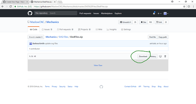

Step 1: Download the files
You can download the files for the most up to date version of the sled by clicking here and using the “download” button on the right side.

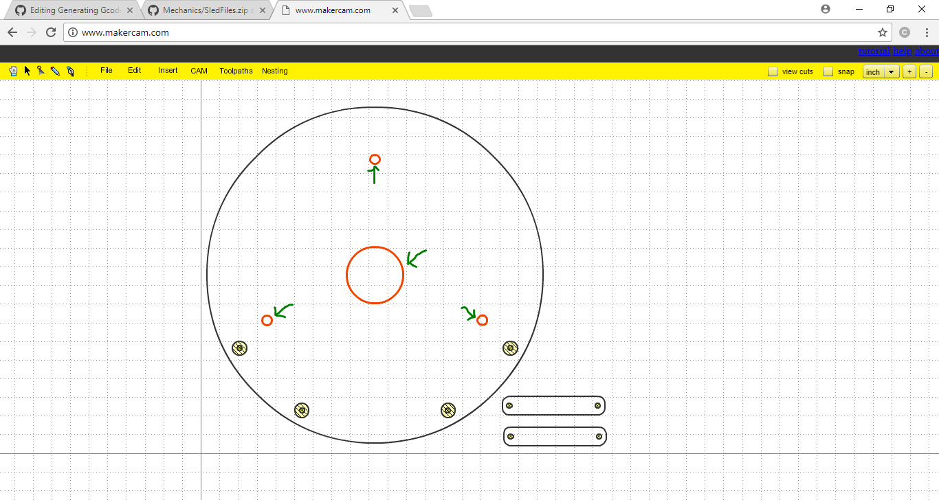

Step 2: Open svg file in MakerCAM
Navigate to www.MakerCAM.com in your browser. If you are having problems with the MakerCAM website, check this thread. Click File -> Open

Step 4: Drill holes
There are three types of cutting operations that MakerCAM can do. It can
1.Drill a hole - When drilling the bit will move straight down to the target depth and then back up to drill a hole
2.Cut a profile - When cutting a profile the machine will cut around the edge of a shape on the inside or outside of a line. The width of the bit is accounted for.
3. Cut a pocket - When cutting a pocket a spiral or zigzag pattern is used to remove all of the material inside a shape
We will use all three of these operations to make the sled. Let’s start with drilling the holes.
Select each of the eight small holes on the file by holding control and clicking on each one. Tip: It can be easier to drag a small box across each one to select them instead of clicking on them.
Then to tell MakerCAM that we want to drill a hole at each of these locations click CAM -> Drill Operation. For the most part the default settings are fine. I changed the depth of the hole to .8 inches to be sure it goes all the way through my .75 inch plywood. I also changed the “peck distance” to .8 inches so that the hole will drill in a single pass instead of a number of “pecks”.
Click ‘OK’ when you feel good about the settings.

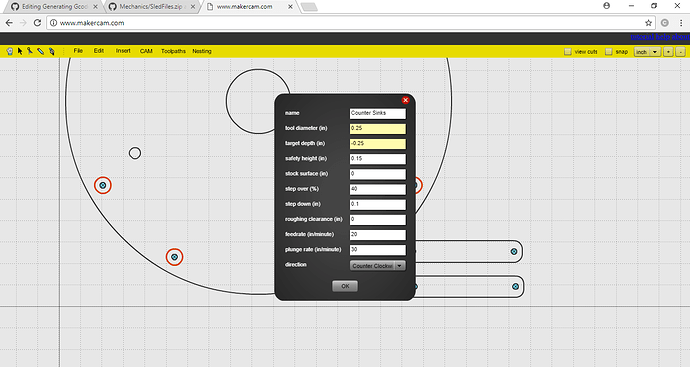

Step 5: Create Pockets
Next we want to create pockets or cutouts for the bolt heads. First select the four outer circles around the circles we just drilled like before. Then tell MakerCAM we want to pocket these by clicking CAM -> Pocket Operation
I adjusted a few of the settings from the defaults here. I set the depth to .25 inches because we don’t want to cut all the way through the plywood, just deep enough for bolt heads to be recessed. I changed the safety height to .15 from .5 because lifting all the way to +.50 before moving is excessive. I increased the step down to .10 because the default of .05 is very conservative, and I reduced the feed rate to 20 in/min because for small cutouts like these going a little bit slower won’t take much time and it will come out nicer.
