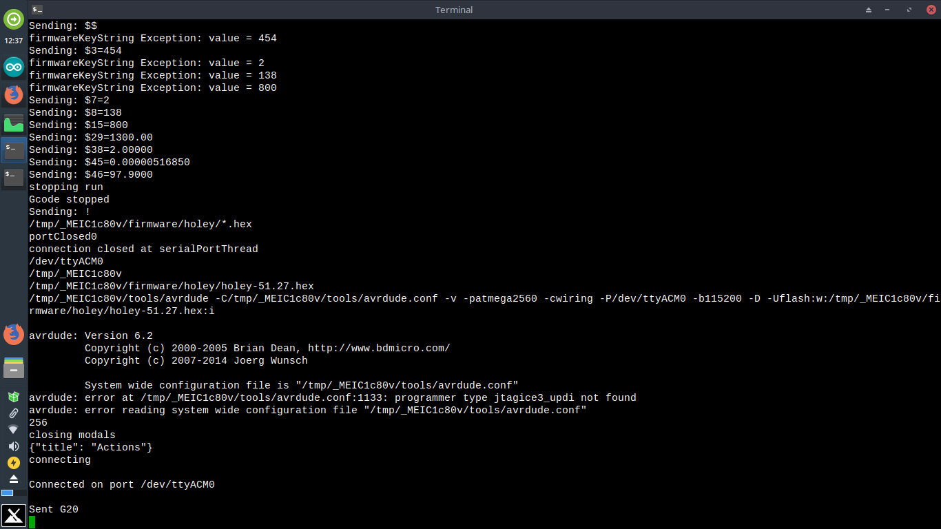

I downloaded the file.
Here are my results:
one. Same error about missing conf file when I try and run upgrade
two. Now I have no left motor.
I unplugged and replugged all cables and still fails.
attached are screen shots
Madgrizzle if it would be easier you can call me.
Apparently the version of avrdude I have on the linux vm is not the newest, so the avrdude.conf file (which apparently is for the newest) is causing issues. So I’ll look into it.
As for the holey calibration being greyed out, your controller is still running the stock firmware (or the ‘stock’ holey calibration firmware)… not the one that comes with webcontrol. If it was a webcontrol holey calibration firmware, it would report Controller: 51.27.
We are making progress… just need to figure out how to get the linux vm avrdude updated.

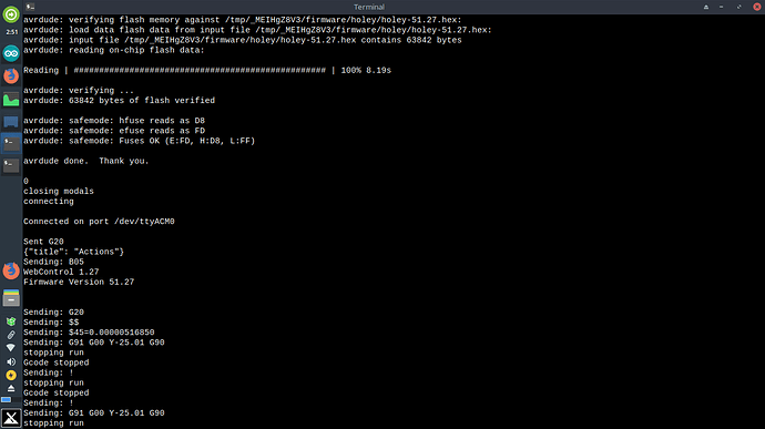

Ok we were able to upload the holey firmware.
BUT all motors fail now.!
[Screenshot-8|690x387]
(upload://aubQ2v7XzDRV1SFZG9qRzL6c9St.png) Screenshot-10
I tried upgrade to 1.26 and the motors work but are out of wack still.
So I again went back to the holey and though it says it is moving motors it is not. And I did not see any error messages.
