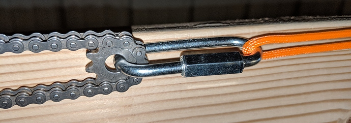

I like the rope through the eye screws with the counter weights. I bought some 1/8 cord and if I get it tight enough for the shorter lengths it ends up being way too tight at the longer lengths.
I’ve been experimenting with replacing my bungee with the 3/16ths cord sold here: Amazon and so far it’s been working really well.
I used zip ties to loop the ends because it was too thick to tie a knot in.
When I was experimenting with the horizontal setup I swapped the s-hooks out for quick links because the s hooks had a tendency to catch. Think I may have to order some of that thicker bungee.

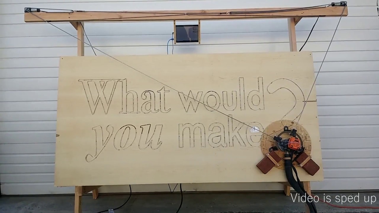

Here’s a quick video which isn’t about the bungee solution, but it shows it in action over a portion of the work surface:
A couple weeks in and I’m really liking the new bungee system :grinning:

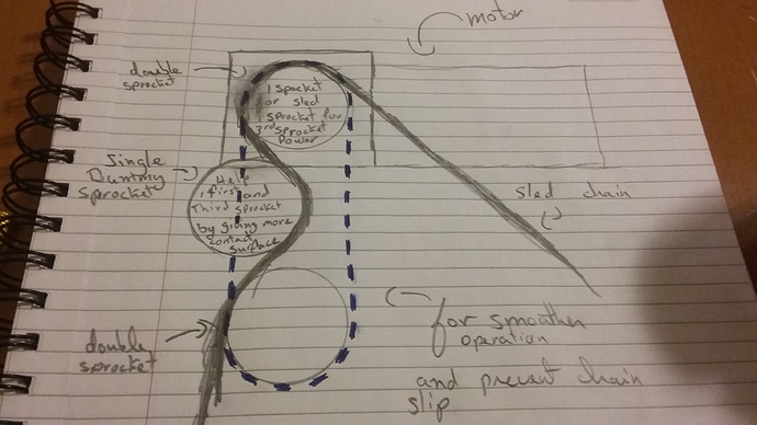

Im still in the settup of the machine, due to special surconstence but, correct me if it doesnt make sence, I would double the sprocket on motor shaft, one for the sled and the other for a another set of sprocket, and that set of sprocket would be on the same shaft into a bracket… the thing is I would put one sprocket like a fly wheel, when the motor goes down fly wheel let go the chain when motor goes up fly wheel grabs engaging tention to the other sprocket on the same shaft…pardon me my english a total of 4 sprocket, a custom made bracket with a fly wheel sprocket and two extra chains.(dont have to be super long chains.)I think it would be a more consistant upgrade.
I think I need a picture to get what you’re saying.
what would the purpose of the flywheel and the other chains be?
I don’t understand the value that this provides?
we want the chain to start and stop quickly so we can move accurately, the speed of the chain is variable (256 levels of power in each direction)

@Elmanifesto, I see now, thanks for the picture. That sort of arrangement could certainly increase the engagement and potentially reduce chain slip. Just based on intuition, I think you would need to carefully design such a system so that the secondary chain is taut. Otherwise, the backlash in that arrangement might make the lower sprockets lag the upper ones, which could make chain slip worse!
Thanks for your idea, and welcome to the forums!
