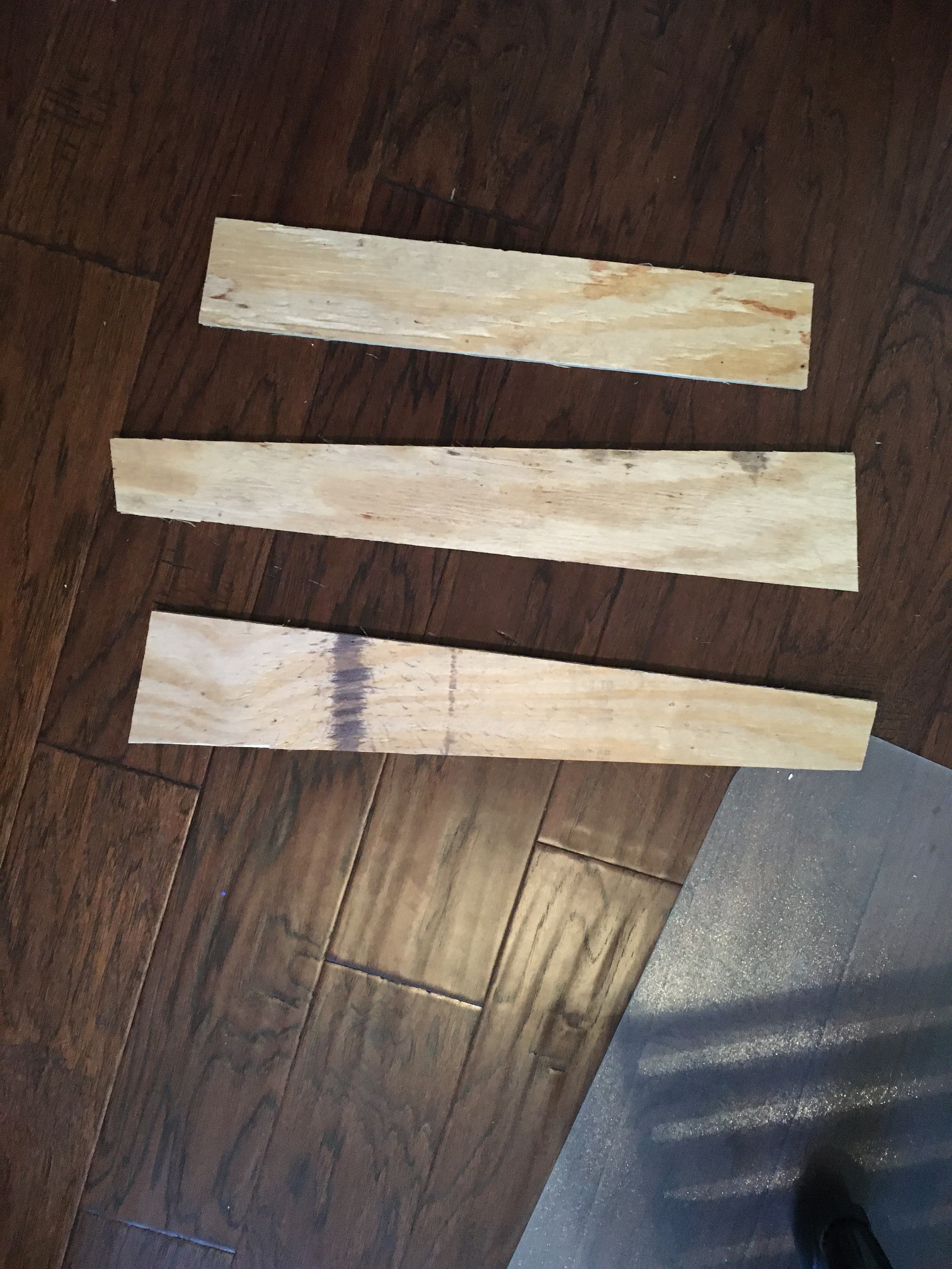

So I have been using my Maslow for about a month now, and I’ve been making numerous test cuts for various ways to make one design. Here’s the shape I’m trying to create:
But, it’s going to be a leg for an end table and it has to hold some weight, so I cut it in three pieces like so:
At first I tried to make a joint between the leg and the crosspiece that resembles a dovetail, or maybe a jigsaw puzzle piece, but none of the tests fit after I cut them. (They all fit together perfectly in Fusion) I don’t have pictures of those because they were cluttering up my workspace and I threw them away. Next I tried a pocket type joint that mostly fit:
(Ignore the notch out of the right side of the leg - the piece I cut it from was a little too small) This might have been a winner, except for the curve at the bottom outside corner of the pocket. On the leg piece, it cut really well:
But on the crosspiece, it looks like the Maslow cut in too deep on the bottom edge.
The curve is supposed to be tangent to both the edge of the pocket and the bottom of the piece. I have been pulling my hair out from this, has anyone else had a similar experience who could help? The other issue I’ve been having is with cutting tabs. When I use Fusion to cut tabs, I get weird dimples on either side of where the tab was after I remove it.
I could sand these out so it’s not a huge issue, but it’s definitely not supposed to do that so can anyone help?
I recentered my router on the sled because it wasn’t perfect and when the sled would turn a little bit, the bit would move. My second z axis had some slop in it with the stock plunge base that would bind and it was more pronounced on long z axis moves. If you are using the stock z axis rigid setup, you may want to check your bungee tension, lube your router base so the router slides freely and possibly tighten the base so the router doesn’t wobble at all, but still slides freely. The tab marks you show in the last photo went away for me when I switched to the meticulous style z axis.
For interlocking parts I have found that keeping the pieces aligned in their desired end position is best. This sucks for using least material but make much better fitting joints. So when you cut your legs you want it laid out as ‘n’ shape like in first picture. With the top piece offset up. If you cut the pieces like in second picture (all parallel) then small discrepancies between X & Y axis calibration become more pronounced. You also want to keep the joints ends as close as possible in layout - so don’t layout the top piece to be cut at the bottom of the legs. Finally you want to flip pieces on their shortest length. e.g. the top piece should be flipped around horizontal axis (upside down) rather than on vertical axis (flipped left to right).
