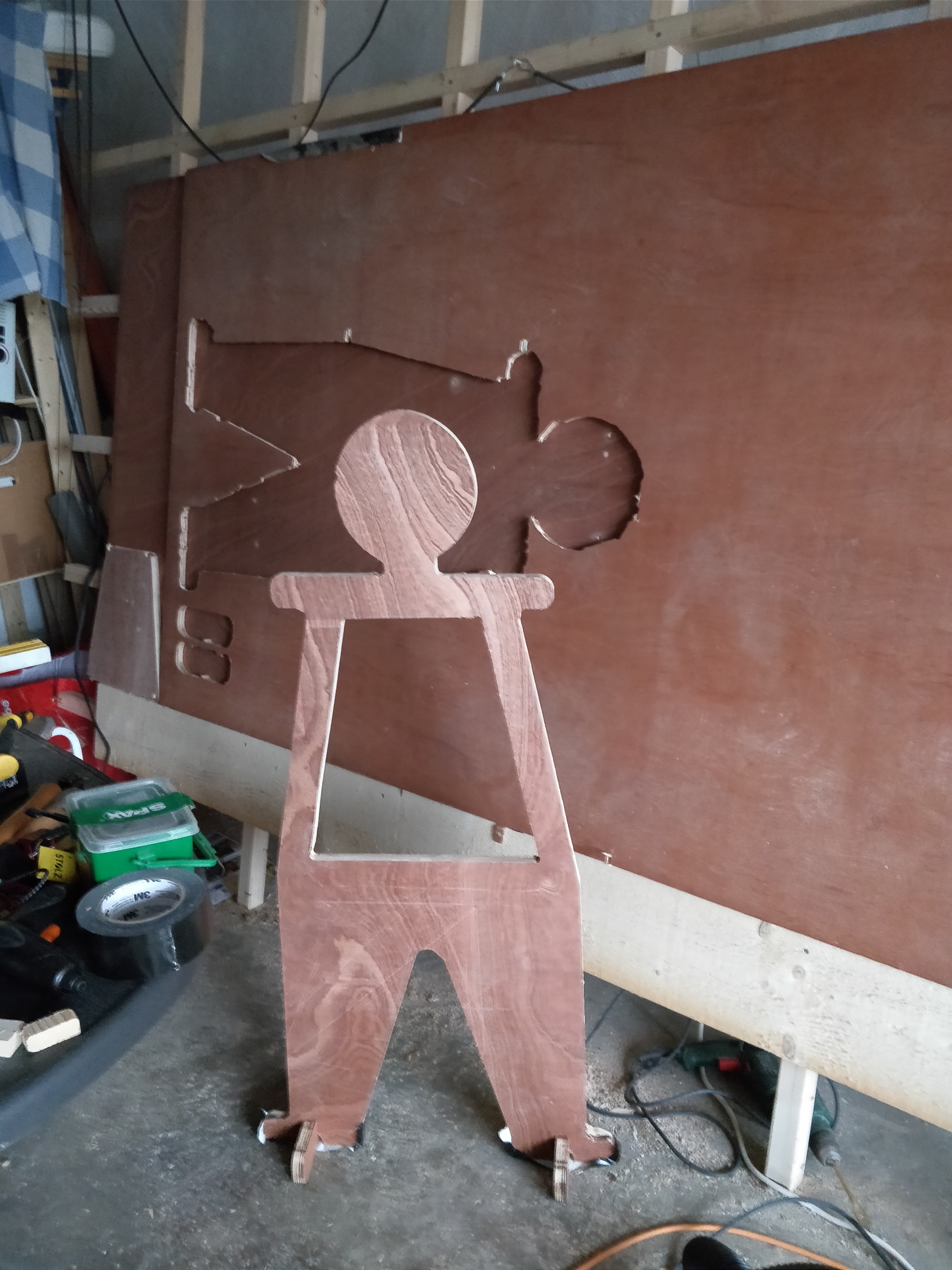

Kid's dressboy - my first attempt besides testing
Made my first real object with Maslow. I calibrated several times and did a few tests before, mostly with mdf and not plywood.

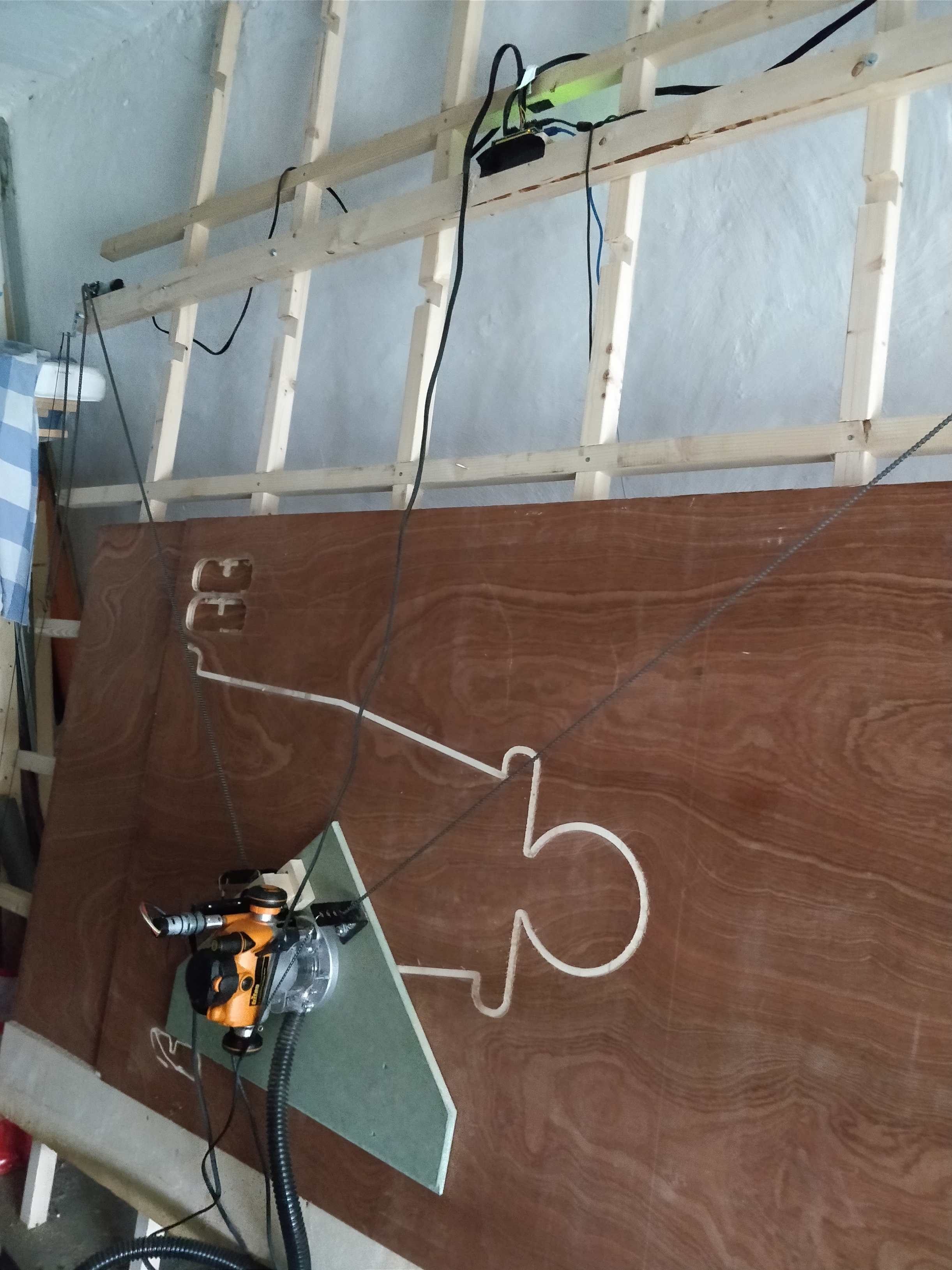

Things didn’t do smoothly, especially the repeatability seems quite off. Every pass ended up several mm offset from the previous pass, in the end my 12mm bit left an 20mm groove.
The Z-axis was also challenging, the router I use has a locking mechanism every 5mm, so I manually needed to unlock it. When I missed the click for locking, the next z gcode would not be correctly executed.
Lost calibration 3 times, I don’t understand why or how this happens.
Finally, it seems I made a depth mistake in fusion360 cam, resulting in a groove of only 15mm deep, leaving 3mm uncut.
I ended up drilling some holes and using a flush trim bit to cut the plywood from the other side and clean up the grooves. I only have one router, so it required me to completely dismantle the sled.
Any thoughts on improving the process would be quite welcome. I’m a real beginner, never done woodworking or design before.

The several mm of offset with each pass sounds a lot like a chain skipping issue to me. If there is one point where the chain jumps a tooth with each pass, you will see the type of offset that you are seeing. If you can keep an eye on the chain sprockets while it is running you might be able to see it skip, or you might just hear a clunk because the skip happens too quickly to spot with the eye. The best solution is to be sure that your sprockets are totally aligned with work surface so that the chain feeds smoothly. If the motor is twisted in relation to the wood, or if it is further in or out than where the chain attaches to the sled it can lead to the chain not feeding smoothly. Another solution is to improve the guides which feed the chain onto the sprockets.
I also remember that your frame is substantially taller than the stock frame. It might be worth testing to see if cuts come out better towards the top of your frame which would be more like the middle of the stock frame as a way to test if the extra height is working for or against you.

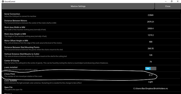

The depth of cut not being the full depth could be an issue in fusion 360 like you guessed, but it could also have to do with “z-axis pitch” setting in Ground Control. Because each router moves a different amount vertically with each rotation of the z-axis motor you might need to change this setting to be correct for the Triton router. The number entered is the number of mm that the router moves vertically with each twist of the knob

For problem 1) I didn’t notice any chain skipping, I will pay attention to aligning the mothers with the sled. Would it be a good idea to encapsulate the chain in a quarter circle of plywood? The taller frame has no calibration issues at the top while testing. At the bottom and near the sides the precision is not good. For the dressboy I moved the sheet to the right to increase precision while still efficiently using the space.

For problem 4), I double checked the value during tests. It’s due to my cam in fusion360. I had multiple objects, the main object I had to flip around to get right for ground control causing the stock to be higher than my main object.
