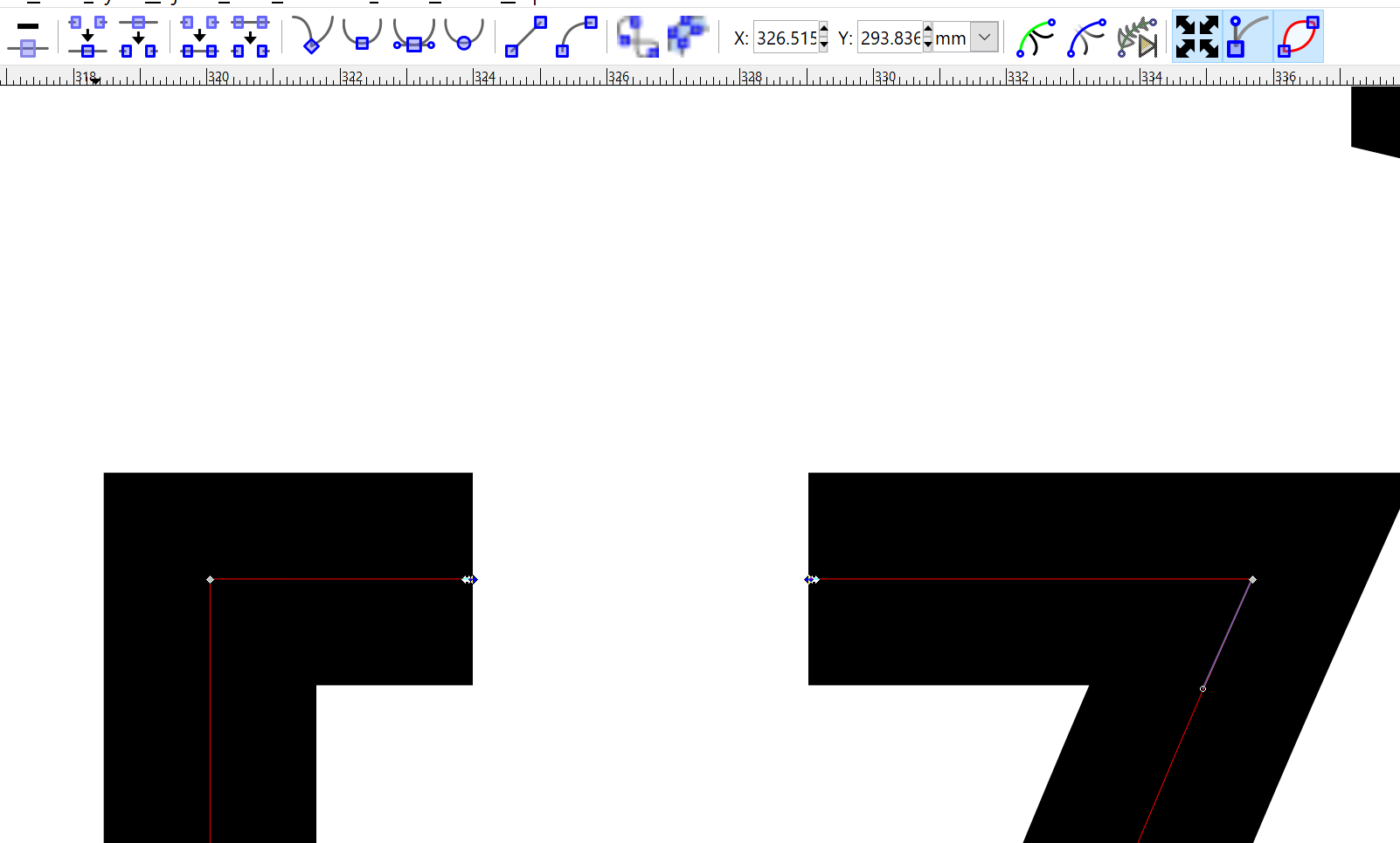

- select your cutout, then choose the node tool (second one down below the select arrow.
-NOTE ON TABS: you will want to put a tab in on any completely cut out part. such as the center of the O, the piece between the M and E, and the little pieces between the O-H and O-M and of course the larger cutout and the sheet you are cutting from. I don’t have a good feel yet for how large the tabs should be. These ones will be 3 mm thick because the last cut will be from 16-19 mm and we are simply going to cut part of the design so it doesn’t get cut. We will start with the little one between H and O and I’m going to try to make it about 5 mm.
to cut the tabs, zoom in and select the cutout where you want to insert, select the two nodes where you want to remove the segment, and click the break node button above on the toolbar. If the nodes are spaced too far apart, double click to add a new node where you want to make your tab. If you are on a curve you might need to break the path first and then delete the segment.
Do this at all places you want to create tabs. I’m interested in learning the rules of thumb for tab placement. This could likely be automated with a script in inkscape if desired, but I’m not the one to do it. This is what I came up with:
