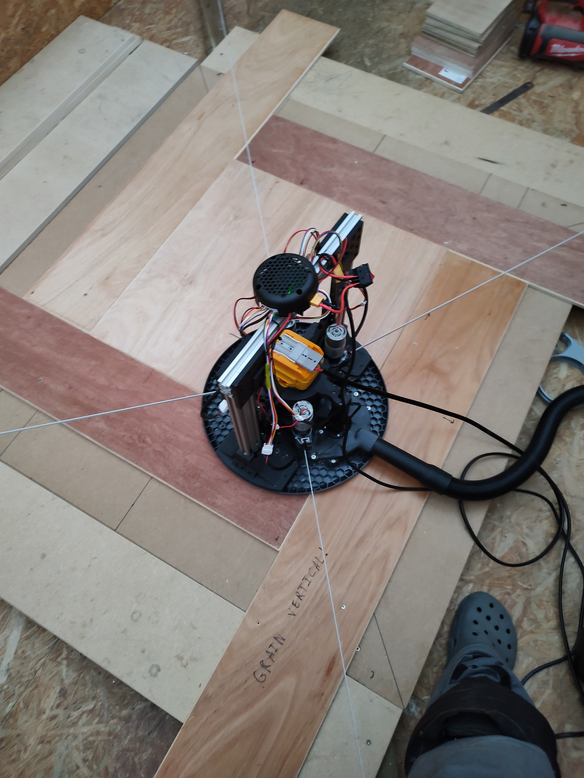

Interesting find - brushless Franken-router setup
Got it installed into my I linear rails-ed my Maslow Maslow (videos in there), after converting it to an over-the-top DC plug connection.
Will have to see over time as i’m trying to push what works with that setup, but it handled 6mm cuts in softwood ply with a 6mm single flute upcut bit at 800mm/s with no problem.
