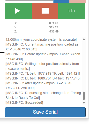

Works as expected except still have a problem with Z value as displayed in attached. Goes wildly negative after power reset.
Going to and from release tension works well. Have not tried a calibration.
This is super interesting, I just gave it a try and I’m not able to replicate that.
It happens every time that you power cycle?
What happens if you press the “set z-home” button?
Not every time and it is not always negative when it happens. Doesn’t always happen, I am trying to identify what precedes it failing. Pressing home Z sets it as expected. I hate intermittent faults.
I think I have found when it happens. (unexpected change in Z value)
I powered on the Maslow, unlocked and adjusted the Z access to set home zero.
I then retracted and extended the belts, all with a value of +4 on the Z access
When I took tension the home position for the z access jumped to +13, which was where it probably was when I powered down last night. I suspect the saved variable is not being updated properly before
It hadn’t moved the Z axis, so I was able lo lower it 4mm and reset the Home position for the Z axis, then raise and continue.

Thank you for the excellent description! I will try to replicate it!

This is perfect. I’ve been able to replicate it and I will work on getting a fix ASAP.
I’ve always been applying tension before setting the z-home so I hadn’t run into this.
I find it difficult to set the Home Z accurately when the Maslow is tensioned, hence the way I have been doing it. The latest way I have been adjusting ’0’ is putting a metal strip flat across the perspex dust cover, bring the bit down to that where I can see it easily, setting the Z to Zero, then removing strip and lowering a known amount which puts the bit on the material and resetting the Z to zero again. Raising it a couple of mm and proceeding from there.
