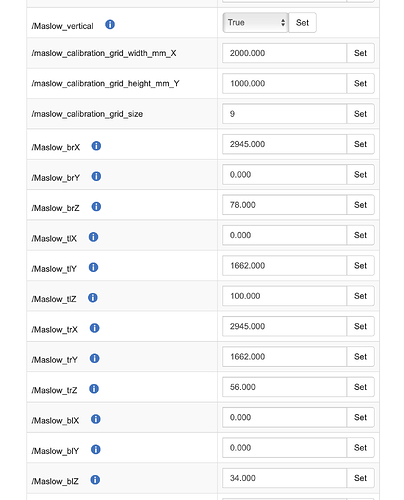

They should be visible in your configuration settings:
I think that this is an important question to answer. It does seem like something funky is going on outside of the math
ah I see cool, I hadn’t seen the extra tab. yep there are some numbers in there. so maybe it is learning.
I had chance to do a couple more test calibrations this evening. I’ve now crafted a calibration sling (piece of rope) to hold the thing in place while I do retracts and extends which helps the grind of all these runs. Managed two runs one with calibration current at default 1300 and another at 1700, just to try something different. These are the full print outs. I’ve not had a retraction error since my early attempts and possibly changing retraction current to 1700.

Ok phew it’s all my mistake, when I read orientation alongside the X/Y dims I was totally thinking printer page setup and I took vertical/horizontal to mean portrait or landscape and was never going to get that out my head. It’s then not a setting you find yourself revisiting. I’ve even seen a comment about mistake understanding Horizontal in a different thread and still I didn’t connect the dots back to my mistake so many calibration attempts before.
I’d be tempted to suggest calling the setting ‘upright’ or ‘flat’ if you find others making the same mistake. Maybe it could also print out ‘starting Horiz. calibration’ or whatever in the messages so when people like me post the logs it real obvious to you guys we’ve messed up.
Indeed, others do make the same mistake. I ended up making a diagram to illustrate the difference between vertical/horizontal and portrait/landscape. I like this proposal, but I think it will take some effort to change everyone’s thinking as we have been using the current nomenclature over countless posts.

Video Link
Serial Messages
[GC:G0 G54 G17 G21 G90 G94 M5 M9 T0 F0 S0]
[MSG:ERR: sdmmc_card_init failed code 0x0x102]
[MSG:INFO: Caution: Unlocked]
[MSG:INFO: Top Right pulled tight with offset -1322.610]
[MSG:INFO: Bottom Right pulled tight with offset -1388.637]
[MSG:INFO: Top Left pulled tight with offset -1760.095]
[MSG:INFO: Bottom Left pulled tight with offset -1720.415]
[MSG:INFO: Zeroing z-axis position]
[MSG:INFO: Center point deviation: TL: 0.148 TR: 0.138 BL: -49.068 BR: 54.393]
[MSG:INFO: Top Left pulled tight with offset -0.011]
[MSG:INFO: Bottom Left pulled tight with offset -0.011]
[MSG:INFO: Top Right pulled tight with offset 0.032]
[MSG:INFO: Bottom Right pulled tight with offset 0.054]
[MSG:INFO: Measured waypoint 6]
[MSG:INFO: Measured waypoint 7]
[MSG:ERR: Unable to move safely, stopping calibration]
No heartbeat from machine in 10 seconds. Please check connection.
I am going to keep playing with the finial guesses and see if I can get through a full calibration but wanted to share this information to see if anyone else can spot an issue I am not seeing.
Unrelated Issue but want to make you aware @bar
When the M4 locks up. I disconnect the power cable to do the hard reset. When I log back into the M4 the configuration settings are all back to 0 (doesn’t remember the last ones) and I sometimes get an sdmmc_card_init error. Even when I don’t get this error if I try to Retract All to start the Calibration process it gives me an error 152. Been getting around this by re-uploading the yaml file.
This error is going to be a product of three things
  1. The initial guess for the anchor points
  2. The locations of the measurement points (determined by the grid size)
  3. The frames actual dimensions
Tweaking those three should be able to make it go away
That error message happens when the belts which should be retracting actually need to extend which could result in the belt spooling out too much and getting stuck in the gears
