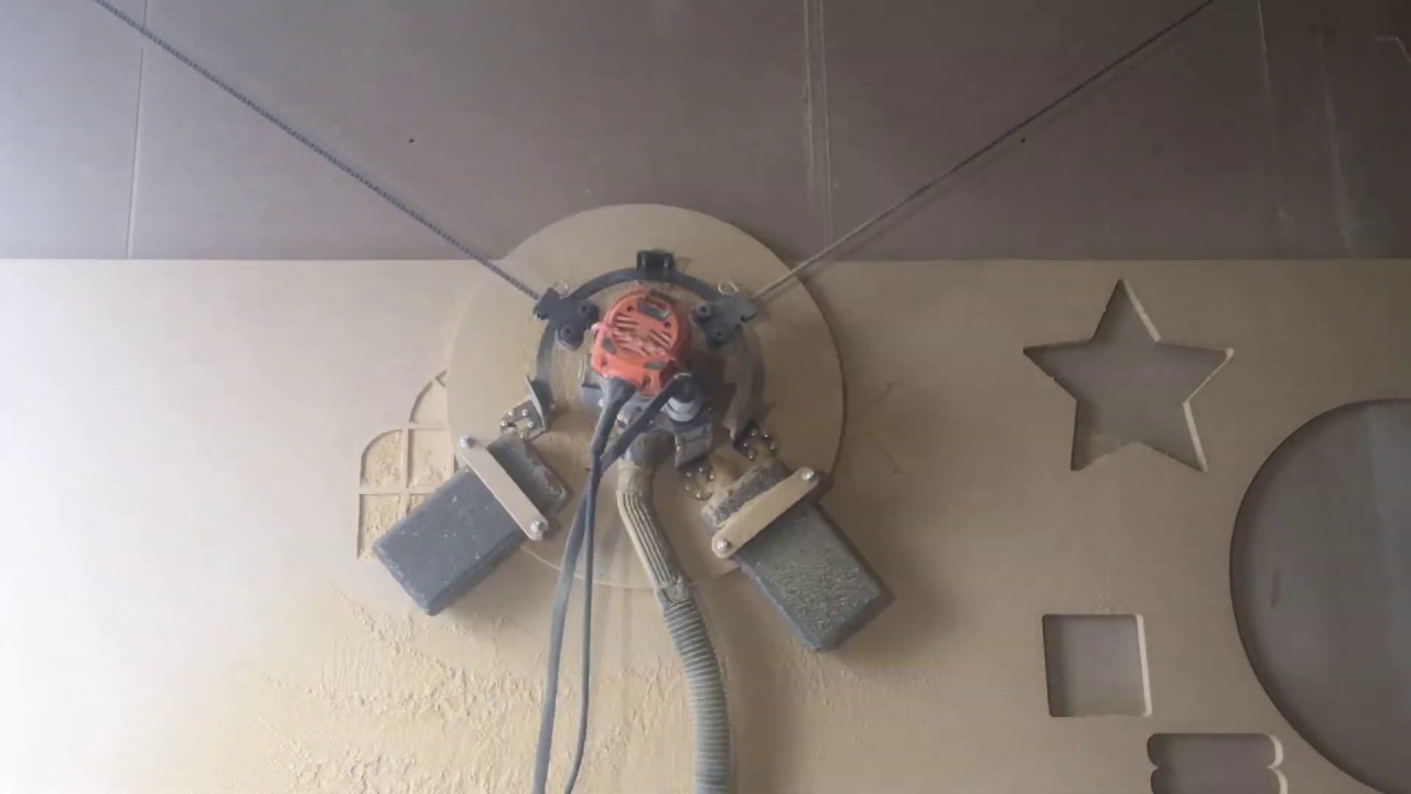

I think one of my favorite things to do with my Maslow is to make it better, more efficient, and easier to use. With each of these things comes challenges and problems, So I will share with you all what I did with my Maslow, how I made it better, what works good and what doesn’t.
First, I will go over the general design and framework, then work my way around the different parts.
I started out with the plain, vanilla frame made from 2x4s and plywood. I did use MDF for the backbone of the frame because of how much cheaper it is. I forgot that MDF comes in 8’1"x4’1" so I do not have it perfectly centered on the machine, but it still works just the same. I bought my machine with the ring kit, and the z-axis kit which I installed straight away. Both of these features are great and make the process much faster and more accurate.

I also have my vacuum port under the plywood just right of center. Some of you may say this is a bad idea due to the router hitting it if I am cutting on lower portions of the board. It is not a problem for me because I tend to make smaller items, so I can cut further up on the board as needed.
Lets start with the dust collection, I had a small 2hp shopvac the I had directly hooked up to the router. This did not work well. The filter was always clogged up, and dust got everywhere. I decided to upgrage to a 6hp shopvac with the Dust Deputy as the dust extractor. This works amazing. I cut a lot out of MDF and as many of you know, MDF makes a very fine dust, so keeping that fine dust out of the air is a priority.
For the system, I have a small portion of piping that goes from the vacuum to the dust deputy, then out the front of the machine. The first picture is of the general area underneath my laptop stand, with my compressor, extension cords, and ear muffs. The second and third pictures show a little closer how I used the small space I had left behind the machine to put my dust deputy! I had just enough room to fit the bucket and cyclone, and there is enough space in the side of the machine to remove the cyclone when it gets full!
