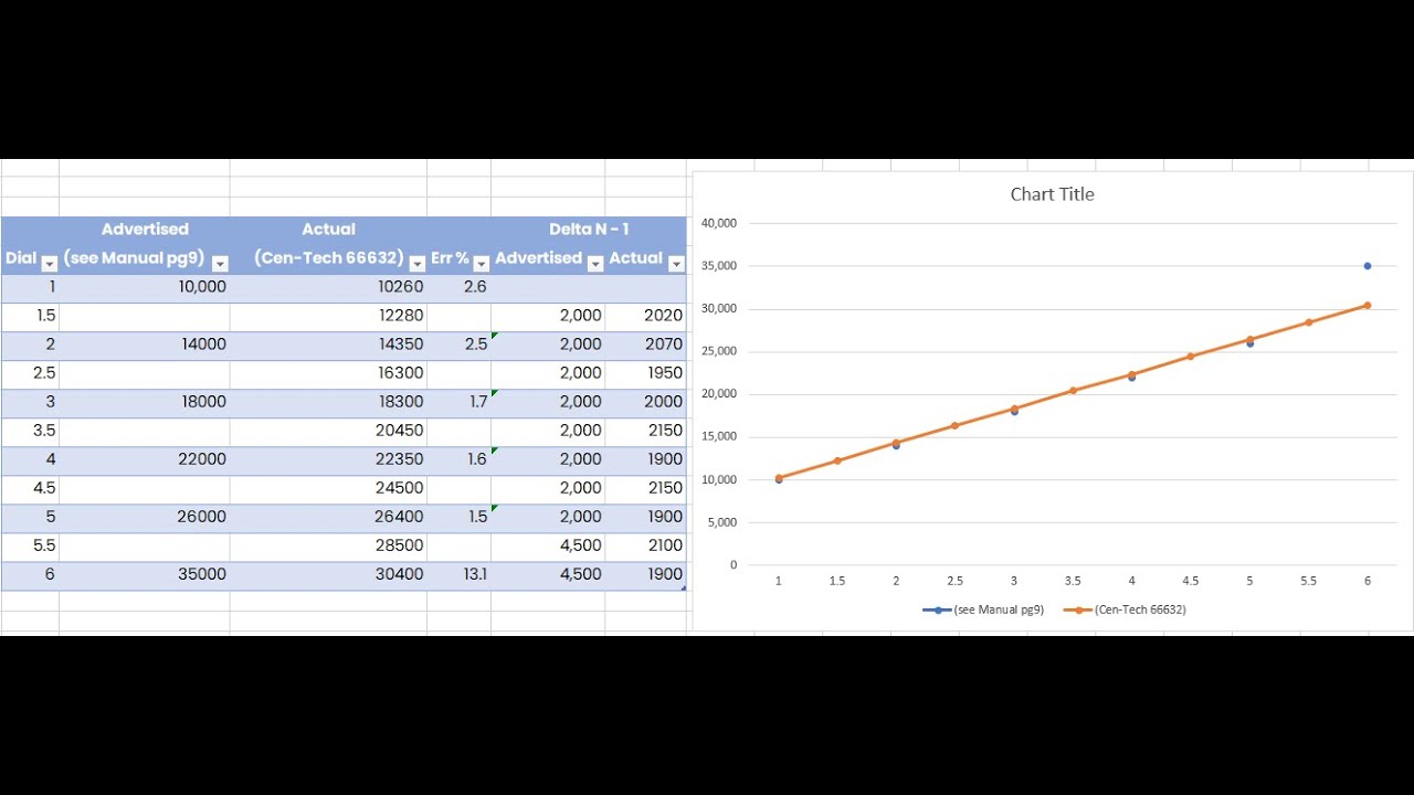

Actually, since i do not know where 3.5" was measured from. I decided to give it a try and see if it might be compatable. Also top speed is 35k not 30k as previously stated. But 10k rpm vs 16k for the dewalt is quite a difference. Also like the collets on it. In a tote somewhere i have every size collet for the er11 chuck.
Router I got goes 10K to 30.5K, couldn’t reach 35K. But that’s ok, am mostly cutting on lowest setting anyway. Observed ~2K RPM change for each indent, they have an indent 1/2 between each labeled setting.
Hope that helps!
