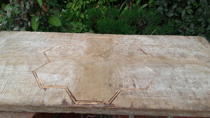

How problem looks? My maslow is not keeping up I’ve set up default settings. Position error on 2, feed rate 800, 0.7mm per pass. After every stop im cleaning work peace witch sand paper to remove splinters and burrs. I’m cutting in part under middle of CNC workspace and it helps a lot. But still, maslow don’t have time to execute 1 order and goes 2 further. It’s always occur on long straight lines.
At that moment i have to go back, remember last order>stop>Run macro to start spindel>go to last order -1 and start again. Rly, i could write an script to make that happen, but there is probably place for GC upgrade. Am I missing something? Variable execution speed?
Plate is light, I didn’t add any weight to it. Maybe removing will help. Blade don’t grind dust thanks to dust collector. Position error must be set on 2.
Motors and encoders works perfectly. I’m cutting in soft wood.
