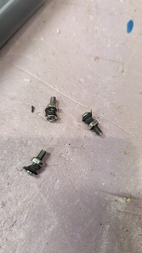

Sounds good. I did start disassembly, but stripped 4 of my M3 screws on the piece that holds the belt stack in place. Must have tightened them too much. Screw extractor set shows up Thursday. Appreciate the help :slight_smile:

Extractor set showed up, but unfortunately I couldn’t get them out as the side the nut was on stripped then went.
So after a few swear words I just drilled them out because there was no other way to take this thing apart.

Was it the heads of the bolts that striped? Send a message with the parts that are damaged to @anna and we’ll get you some replacements in the mail.
