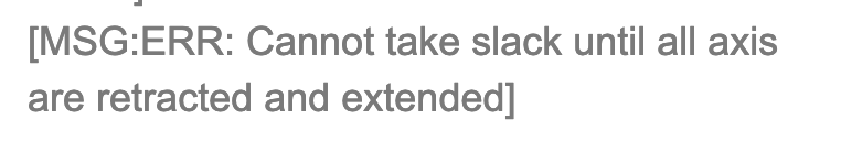

So post yaml upload and reset I hit “take slack” like the user guide suggests. The machine does not move though.
[MSG:INFO: Took measurement at waypoint 0]
[MSG:ERR: Position error on Top Left axis exceeded 1mm, error is -2125.622mm]
[MSG:ERR: Position error on Top Right axis exceeded 1mm, error is -2159.201mm]
[MSG:ERR: Position error on Bottom Left axis exceeded 1mm, error is -2146.453mm]
[MSG:ERR: Position error on Bottom Right axis exceeded 1mm, error is -2166.800mm]

Let me check that it’s working right for me
It’s slightly concerning that these numbers don’t match up with the ones that I computed earlier, but that’s not the issue with takeSlack
If you do Power off → Power On → Retract All → Extend All do you see the same thing?
The machine is sitting where it was after calibration.
Ah after the restart it needs to retract and extend all the belts again so that it knows where they are.
Any time that the machine restarts (like after changing the config file) the machine doesn’t know if it’s been off for 1 second or a week so it assumes that it’s starting out in a totally unknown state and it won’t do anything until the belts are retracted so it can zero them.
I’ll add a warning message to take slack to make that more clear.
I’ve added a more clear error message in this case.
