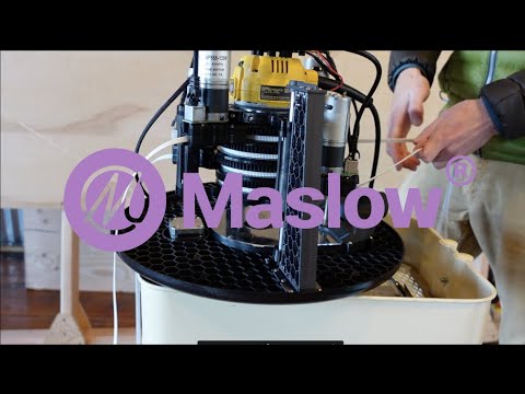

I think the assembly guide should show how to install the bit and what you are supposed to do with that plastic thing you 3d printed.
Seriously I just got some fresh gcode off estlcam and I have no idea how to do this.
Fred
The process is in this video. Let’s add it to the assembly guide or user guide.
I agree, a ā€œhow to cut somethingā€ video is very much needed. We got bogged down in fixing issues, but we should get one of those made ASAP
