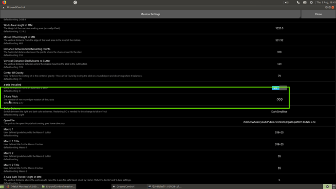

Order placed. Thank you very much. Are there any special calibration settings that I need to use with the new z axis kit?
The z axis on the upgraded metal sled has a lead of 8mm. The default is about 3, so the upgrade is about 3x faster, one can buy differnet pullies on top to make it even faster if wanted.
4 x times 3.17 mm = 12.68mm. I dare to doubt that this is recommended.
Wow, that lead and pitch on the screw would interest me and the gear ratio please…
If ‘gears’ are involved the answer could be correct, i do admit.
The easy way to be sure:
If you make a thin mark on the coupler or gear (Z-motor side), in line with a reference point on the Z-motor mount, and use the z-menu to turn the Z-motor ~exactly 1 round, with a callipers measure the mm Z moved, you can set the exact movement in GC clicking on ‘Settings’
and adjust the value you measured right here and you are good to run.
If Z turns the opposite direction, add or remove a minus { - }.
I prefer the route of editing it with a txt editor in the groundcontrol.ini found in your {user folder on top level}, with GC closed. The value name is
zdistperrot = ???
Kind regards, Gero
I’d love your recommendations: What is the best frame to build to use with the metal maslow and metal top rail?
If it’s a c-beam, the lead screw is a 4 start 2mm pitch 8mm diameter acme screw. So, if it uses the same size gear pulley for both the motor and the c-beam, you would want to use 4*2=8mm pitch in ground control. (really the label in ground control should be “lead”, not “pitch”)
Increasing the Z speed with the $18 command came with a warning that it could influence the x/y/z coordination. Increasing was giving me accurate z-feed rates (g-code), but never tested in real cuts on the effects.
Do you have a opinion on that?
:100: :+1:
Edit: 4 threads on a 2mm pitch screw will give 8mm lead (movement), 2 threads will give 4mm and 1 will give 2mm.
the lead is 8mm, just measured it to make sure.
I’m only partially following (especially the term pitch for the turning of the rotor?) but I’m seeing the problem with the z-axis not moving the correct amount on my metal maslow. Should I change the 3.17mm value to 8mm to fix this?
And THANKS to all you big brains out there making this work! :slight_smile:

The terms “pitch” and “lead” can be confusing. Pitch is the distance between threads on the screw. Lead is the distance the nut (and hence the router) moves with one full rotation of the screw. The two values are related by the number of starts. If you look at the end of the screw, you should be able to see the number of threads that start at that end.
This post (Don't understand number I needed to calibrate my Z axis) might help you visualize the difference.
